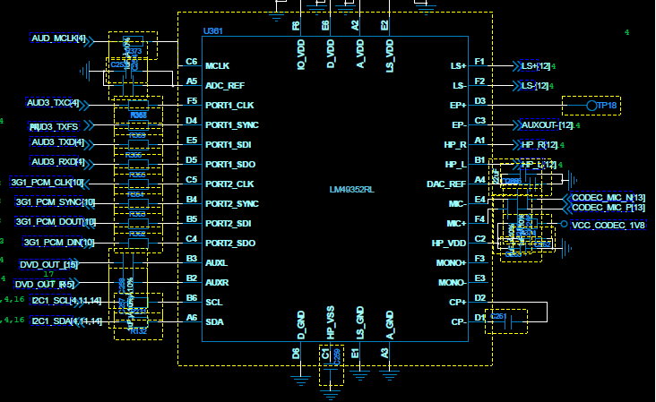

Hi All,
We are using LM49352 in our project for following config.
Port 1 -> for I2S playback with LM49352 as clock & sync master
Port 2 -> for PCM for 3g Audio call with LM49352 as Slave
We have finally brought up basic things but still we have the following issues
1. Left channel audio is not working in I2S mode
2. Heavy noise in 3G voice call.
We are totally stuck here. Since we are not getting the support from respective FAE also
We are in the crucial stage of project completion.
Can anyone help us to sort out the issue.
Your help will be highly appreciated !!!
Thanks and Regards
Sriram.
  • Hi Sriram,
    I will try to help you with this issue.
    Could you upload your schematic and show me all the register settings?
    Andy
  • Hi Andy,
    Thank you very much for your valuable time.
    We have managed to solve the left channel issue by keeping LM49352 as slave.
    But noise in 3G call is not yet solved. There is no way around to solve it other than changing the register settings.
    I have uploaded the schematics and register settings used for 3G Voice call. Please refer and provide suggestions.
    Audio Data Used:- PCM 16 bit depth data, 1 channel, 8 KHz Sampling rate, 2.048 MHz Bit clock, LM49352 as Slave

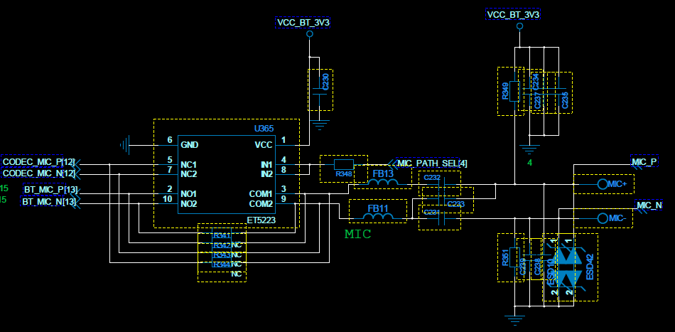

  • Hi Andy,
    I meant that register settings is the only way to solve this noise issue. So far we couldn't  solve the issue .
    And we getting the noise only in Microphone. The headphone output is pretty clear. The issue must be in the ADC configuration registers.

  • Hi Sriram,
    Did you try enabling the ADC DSP engine inside? I took at a look at your register settings and you enabled the DAC's ALC, but I didn't see you enable the ADC effects yet. The LM49352 is a legacy device which doesn't have an official EVM now, so it is difficult for me to verify your issue.
    Regarding the register settings for ADC to get Mono PCM data from microphone, I don't have them. However, I think it might be good for you to take a look at the link:
    mailman.alsa-project.org/.../037806.html. The web page shows a Linux driver for LM49352, which seems to have some good register settings. In addition, the ADC DSP engine is enabled in this driver code.
    Andy
  • Hi Andy,
    We have tried those settings from that driver file already but no improvement . That's why we disabled ADC ALC. And without ADC ALCs, the noise is little low.
    Actually we are using electret microphone with ferrite bead. Is that okay?
    Do you suggest any hardware modifications or microphone change in the hardware?
    For you reference, i have attached the ferrite circuit. Pls suggest if any.
