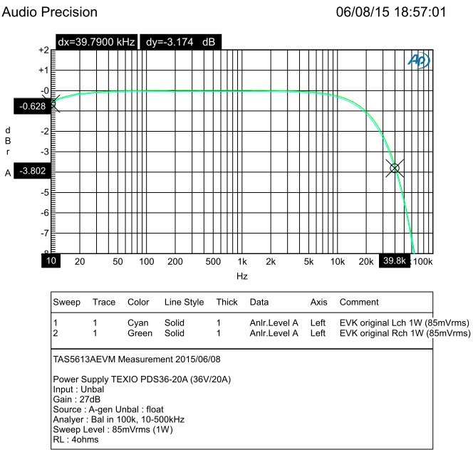

I am evaluating TAS5613PHD2EVM.
I have question of frequency response.
I got response at 40kHz/8ohm
However I could not get responce at 40kHz/4ohm.
Dose TAS5613 guarantee 40kHz/4ohm.
Ther was not description at data sheet.
See attached picture.
What should I aim at to select of 40kHz at-2dB at 4ohm?
*40kHz-2dB is requirement of DTS license.
  • Hi Masaki,
    This response may be related to the output filter. The filter values from the EVM  were calculated to have keep the audible frequencies using 4 Ohm load, if you want to extend the cutoff frequency, you could try changing the inductor to 7uH. Using 8 Ohm load changes the filter response and extends the cutoff frequency.
