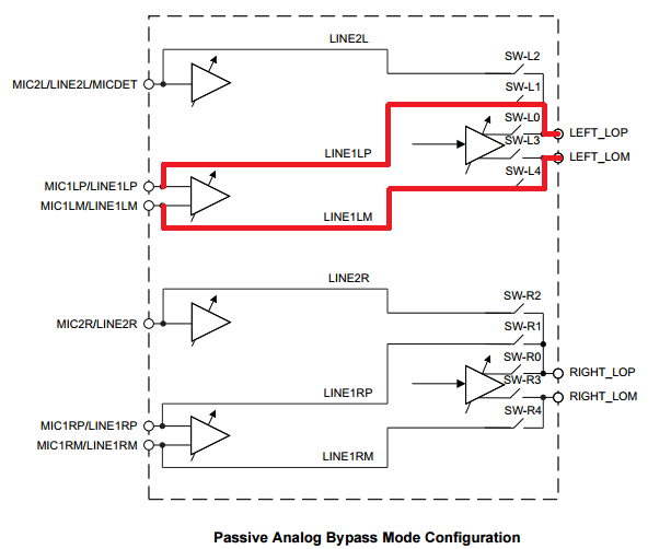

Our project(cell phone) need to do bypass function with tlv320aic3104 codec .
LINE1LM / LINE1LP as  mic_in  and  LEFT_LOM / LEFT_LOP as mic_out (differential mode),
while I don't know how to configure the register and how to test this function . would you please to give me some help info.
temp setting list below.
: write 108 0x03   //  passive analog bypass mode configuration
: write 81   0x51   //  PGA_L is routed to LEFT_LOP/M
: write 86   0x99   //  LEFT_LOP/M is not muted
Thanks!
jimmy
  • Hi Taotao,
    The bypass path is used in order to connect the input to output directly. The next picture shows in red the path that you must to use in your project if you're searching for configure the bypass path.
    Regarding the register configuration, you only need to configure register 108 (0x6C) as 3 (0x03) to use it. Register 81 and 86 can be omitted. I hope this helps you. If you still have questions or comments please let me know.
