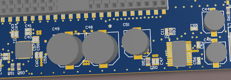

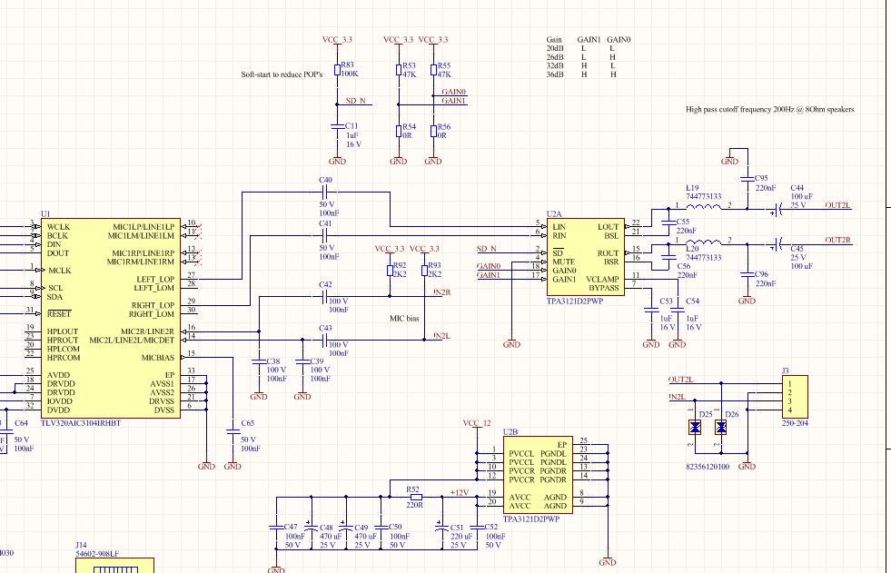

I am having trouble to get a TPA3121 to start. Refer to part of my schematic below.The amplifier is connected to an Audio codec, with which succesfully generates audio signals.
However when I measure on LOUT and ROUT, both outputs remain silent (0V).
I have tried shorting R83 (connecting SD_N direct to VCC_3.3), but the issue remains.
Any help how to resolve this issue is much appreciated!
Note that initially L19, L20, C95 and C96 were not present in the design, but I patched these on my proto board. The issue remains.
