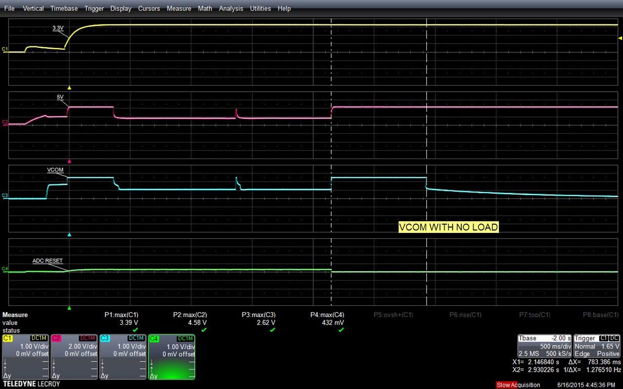

I have some PCM4204 parts where the VCOM output is not working correctly.

  • Ok well then, do you have any idea of why the VCOM output would be acting the way it is? (please see the scope capture in the previous thread)
    I have tried grounding the test pin and it makes no difference.

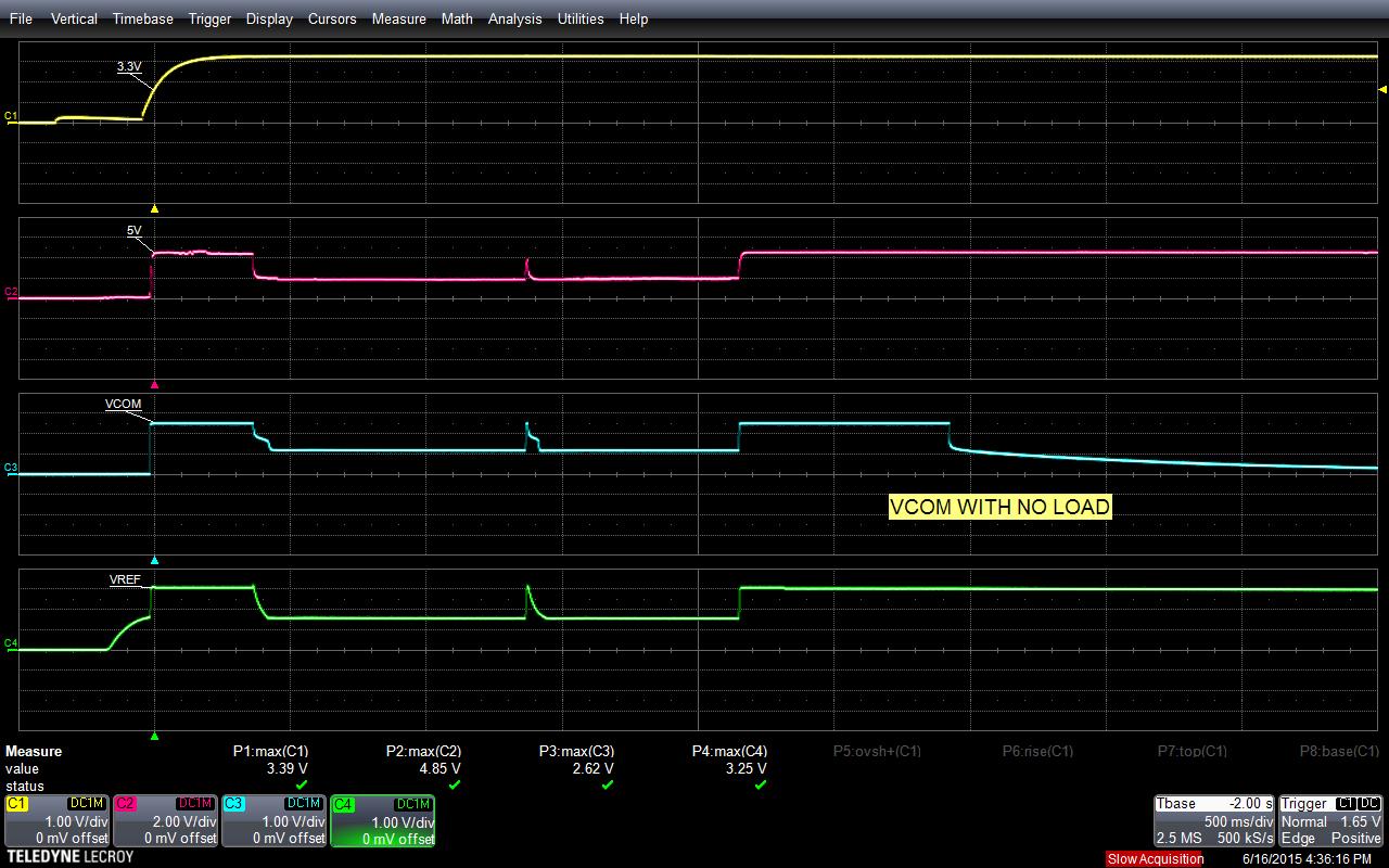

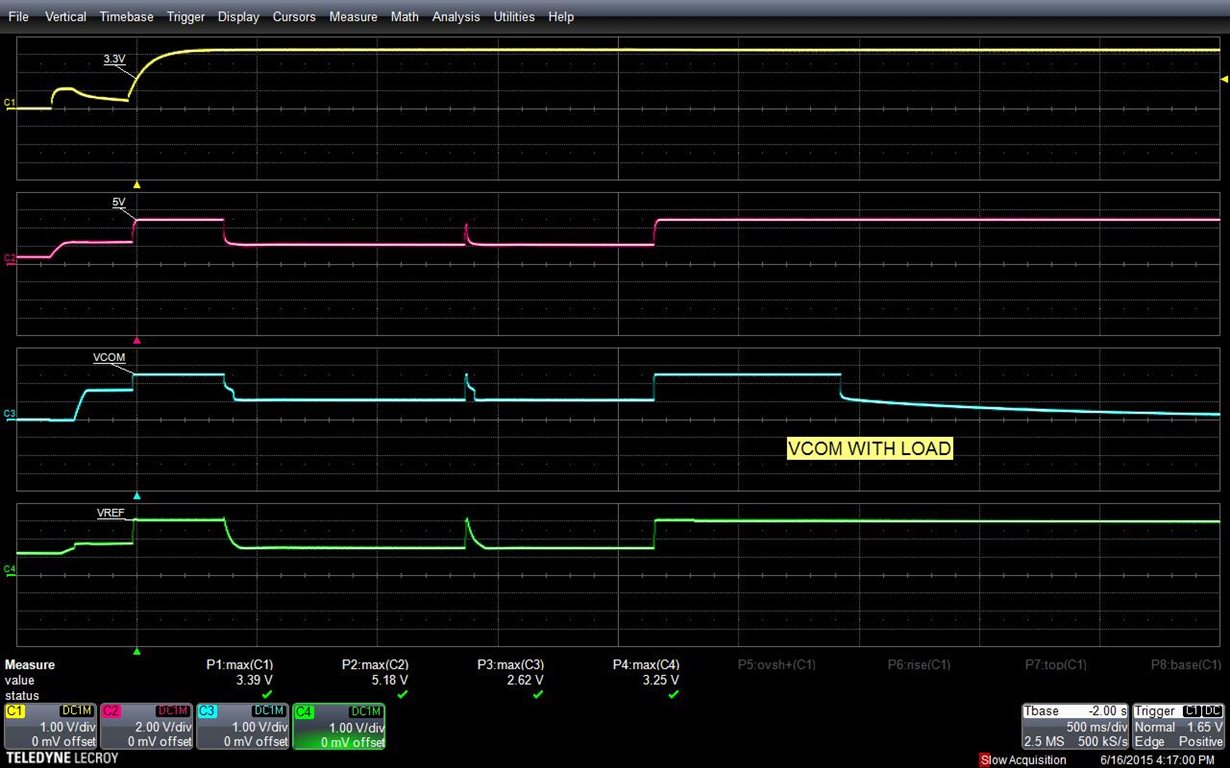

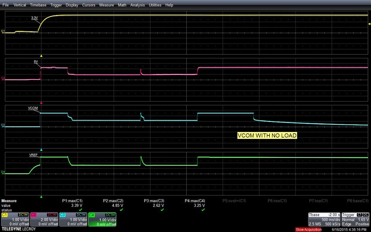

  • Here is some more screen shots of the problem. VCOM tracks 5V for about 800ms and then drops rapidly to 1V and then slowly decays to 0V.
    This happens with and without load and with the test pin grounded.
  • For some reason the screen shots did not appear in the last post. Here they are:
