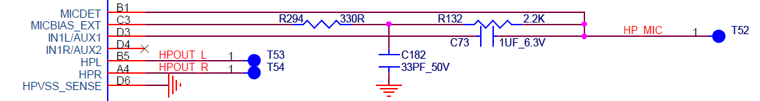

TLV320AIC3262 Audio Codec - microphone noise
Dear All
Our customers say that quality of our headset-microphone is not good.
They can hear a lot of noise.
What can I do to reduce this noise? Modify my layout or schematic?
Thanks~

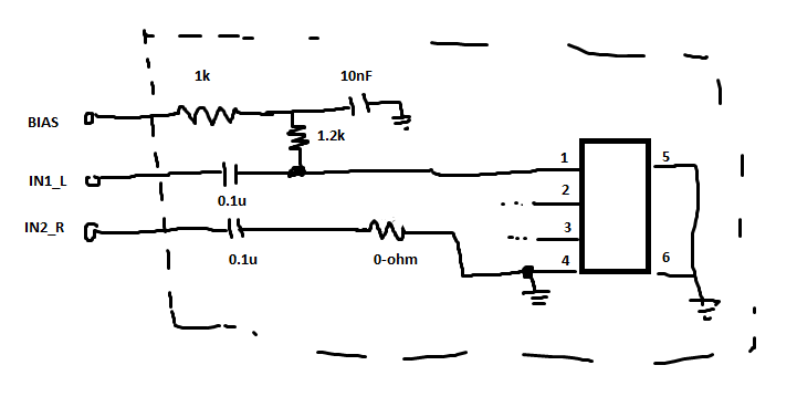

Dear  J
Thanks a lot!!
I modify schematic.
I will place the mic & micbias in a clean GND layer and with GND trace.
Will the mic quality be better if I change to use mic differential input (IN1L/IN1R) ?
Thank you very much!!

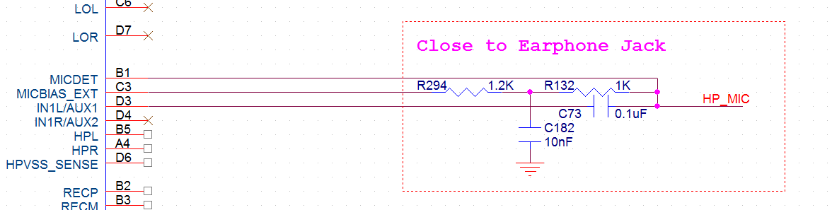

Dear  J
Thanks a lot~~
As your links,
"Sensitive signals use differential"
"Place 33pF caps from each input to GND"
"Route the signal between ground planes and shield with GND"
but my earphone jack is not a "differential microphone" I modify my sch as follow jpg.
Would you please help us to check?

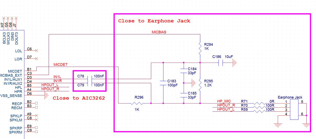

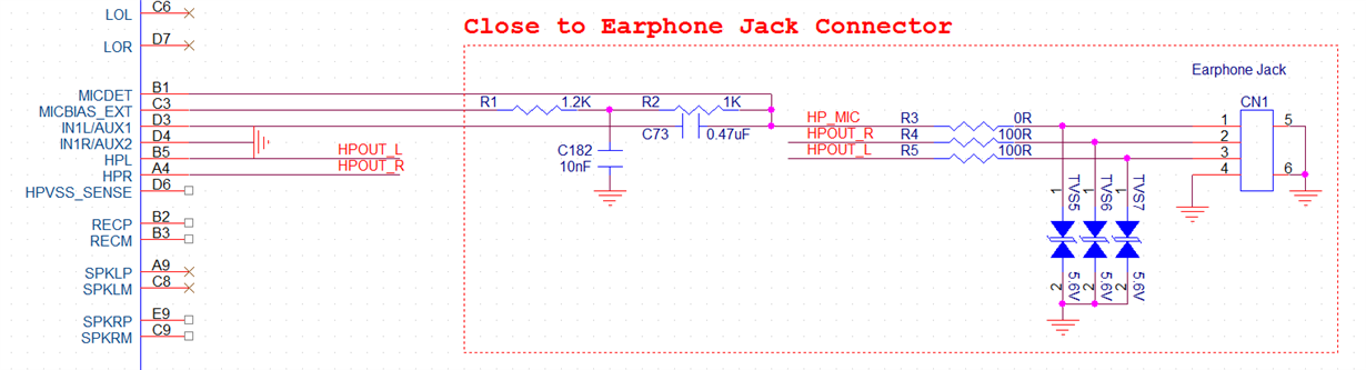

Dear J
We had modified our sch as follow JPG.
Would you please help us to check it?
