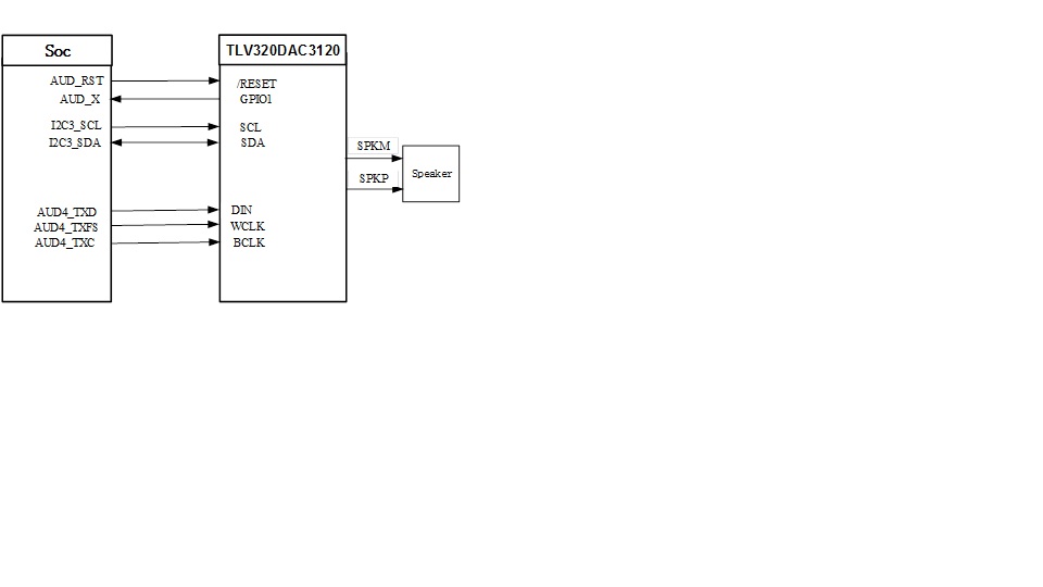

Hi Masters,
I have some questions on using TLV320DAC3120, could you please help to answer the below questions:
1.Is there any power on/power down sequence requirement on IOVDD, DVDD, AVDD, SPKVDD and HPVDD?
2. Is there any detailed power on and power down sequence on the internal blocks, if yes, could you please help to list it?
My understanding:
For power on: PLL->NDAC->MDAC->DAC->Power stage
For power down: Power stage->DAC->MDAC->NDAC->PLL
3. Can the miniDSP be bypassed(disabled) , if yes, how to bypass it?
4. Can the DAC processing blocks be bypassed? if yes, how to bypass it.
5. For the below application, do we have related register configuration? (16bit I2S, 128OSR)
Thank you very much.
  • 1. All power supplies must be up before you release reset. They should come up within a few ms. The order is not critical but they all must be up before you release the reset signal (10ns after stable supplies)
    2. Your sequence is correct
    3. You can indirectly bypass it by selecting a processing block (any) and leaving the coefficients at the default setting (all-pass).
    4. No
    5. The EVM init script uses a similar configuration.
