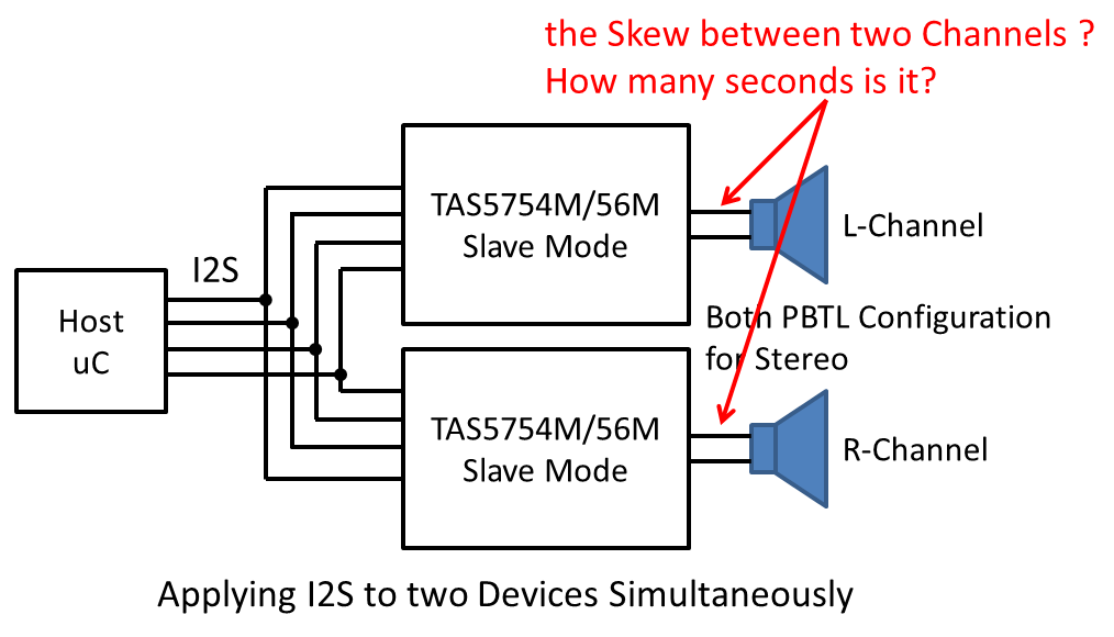

Could you please give us your advice regarding the skew between two channels if configuring two TAS5754M/56M with the slave mode as below ?
Kato
HI Kato-san,
If the processing and L/R data are the same there shouldn't be any audible difference between the two by design. We haven't explicitly test this use case for skew, but we have built several applications and other customers as well using multiple TAS5754M and TAS5756M with no issue with skew.
