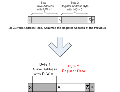

I have one suspected point about Read format of DIX4192 Datasheet.
I believe that read format of "Figure 20" should be changed as shown below.
Is my understanding correct ?

Hi Machida-san,
I have ran some tests with a launchpad and I agree that the figure should be changed to reflect what you have shown in your origional post. When you perform a read request without a write for register address, it will return the value of the last register read or wrote to. This means figure 20(a) should be slave address sent from master to salve, then register contents sent from slave to master. We are planning to update the data sheet for the DIX4192 in the near future and will make this change. Thank you for pointing this out to us.
