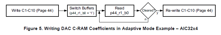

At the time to write the i2c script to update the first coefficient value of my PurePath design ( C_to_D_1 ), I am a bit confused
with the switch of the buffers.
I got those coefficient regularly and constantly every 100 ms.
What is unclear to me is the documentation speaks about auto-clearing bit but in the Evaluation Module it's not seems to be the case.
#switch off
w 30 00 08
w 30 01 04
#switch on
w 30 00 08
w 30 01 05
it stay in this state when I refresh the GUI with the button.
So can you help me with that and provide me with the correct sequence.

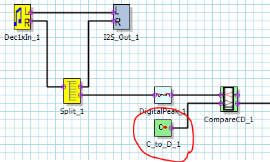

Here is my design.
    You first need to find what the page and register location of C_to_D_1 is in its properties window. Let assume it is Page 8, Registers 8-11.
    # Page 8
    w 30 00 08
    # Set Coefficient to 0x000001
    w 30 08 00 00 01 00
    # Swap Buffer
    w 30 00 08
    w 30 01 05
    # Wait until bit D0 clears
    # Page 8
    w 30 00 08
    w 30 08 00 00 01 00
    An example can be found in the AIC32x4 Design and Configuration Guide app note in the TLV320AIC3254 web page.
