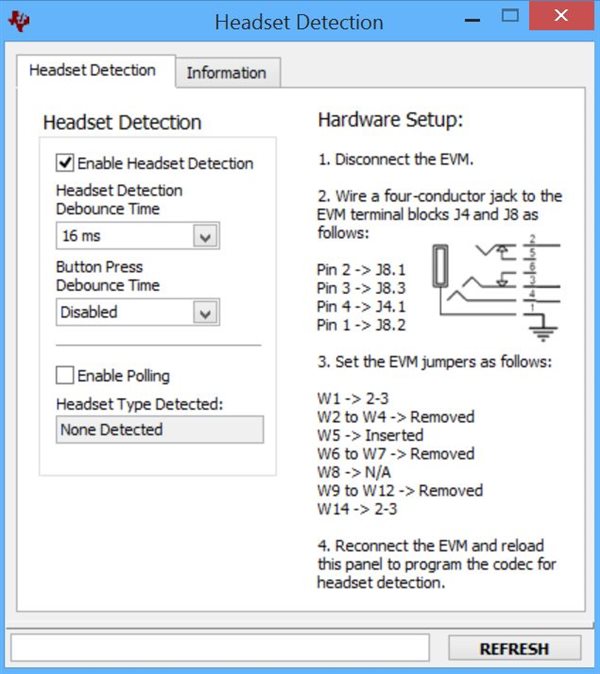

  • Hi Praveen,
    Please see the attached script. It's an example of the Headset Detection in the TLV320AIC32x4EVM.

    # Page 0
    w 30 00 00
    # Headset Detection Enabled
    w 30 43 80
    Additionally, the hardware configuration is important too. The instructions to configure the hardware in order to use the headset detection (in the EVM) are in the following picture:
