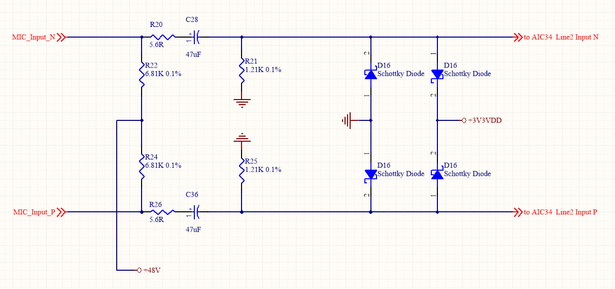

I am debugging a new design with the TLV320AIC34.
So far the codec is working fine but I noticed strange behavior with only some boards.
For some input channels the left and/or right PGA gain control setting does not work correctly.
There are audible blobs in the audio signal when changing the PGA gain setting and sometimes the audio signal is muted when a certain PGA gain is selected (most likely when setting very high gain)
I have some boards showing this problem and some boards are fine. Sometimes the problem disappears when re-testing the board. It is really hard to catch.
While debugging this problem I also noticed that the codec is getting hot. It consumes 200mA on the +3.3V DRVDD power rail.
Powering Down the ADC and the High Power drivers doesn’t change the higher current of 200mA.
I am little bit out of ideas what can such a behavior and the higher power consumption.
Can a bad initialization sequence cause such a behavior? I already changed the power on Reset and the power sequence without success.
Any help would be greatly appreciated.
