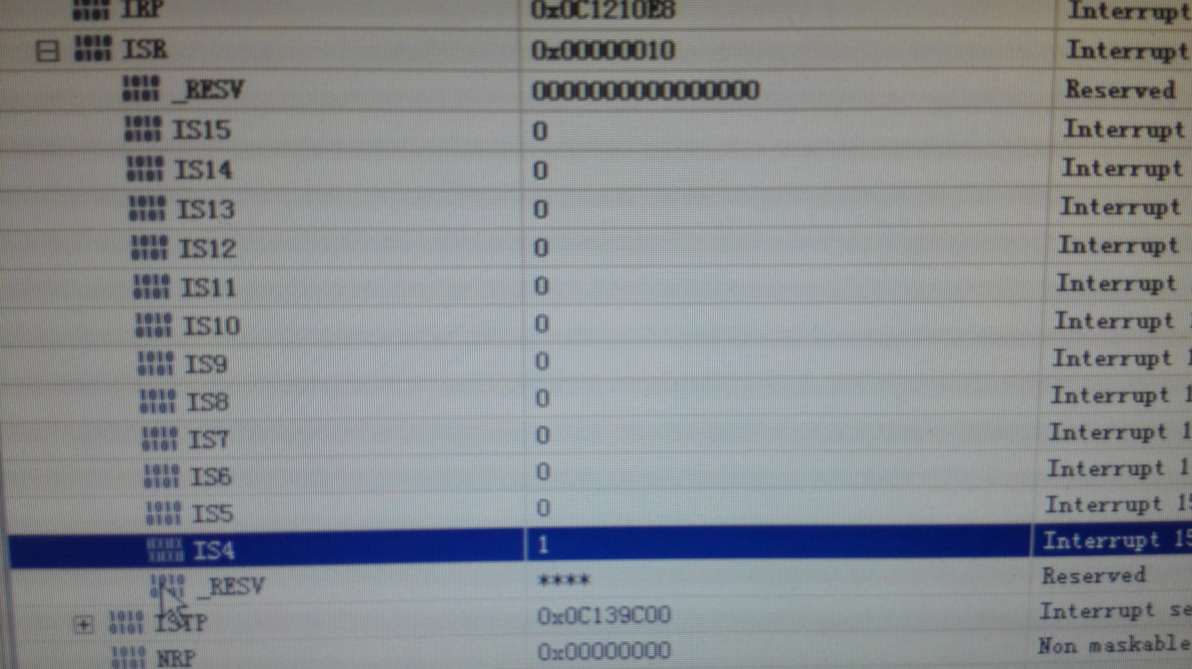

    from the picture you can see that the Master core use the Function MessageQ_put() to send the Message to the slave core.
    from this picture wo can see that the slave core use the function MessageQ_get() to receive the Message form the Master Core
    I do think the Communication between the Master Core and the Slave core is interrupted by way,The following operation seems to validate my thoughts.
    Through breakpoint,When this interaction occurs,I see the ISR Register,you can see the value of IS4 is 1.so i think the priority of MessageQ using in IPC is 4.
    My problem is that whether this interrupt can be set by myself? for example ,I want to set the priority of MessageQ in IPC is 8.
