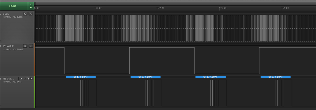

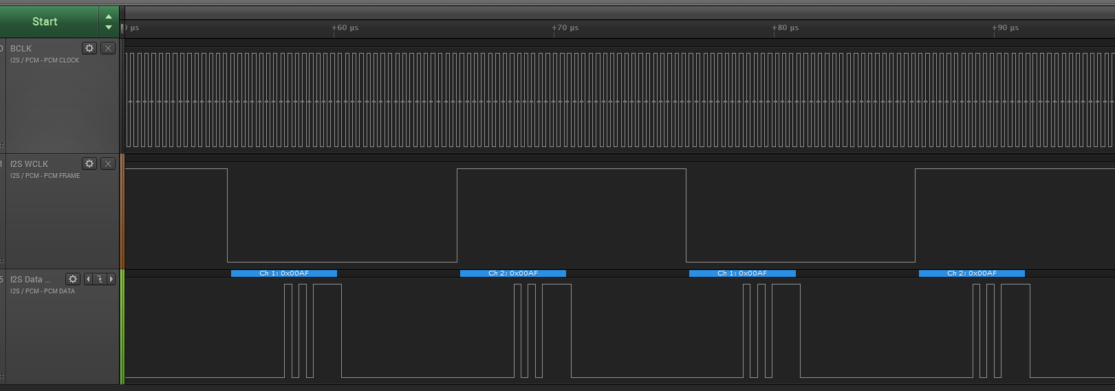

Good day,
I'm using a kl16 cortex m0 MCU from Freescale together with an TAS2505. The audio data is streamed via I2S to the TAS2505 and the configuration data via I2C.
I was following the 4.0.7 Example Register Setup to Play Digital Data Through DAC and Headphone/Speaker Outputs in the slau472.pdf. I can hear some audio coming out of the speaker, but very distorted and not at all like it is supposed to be.
Anyone has a similar experience?
My setup: using digital input with I2S, MCLK from an external source, WCLK and BCLK provided by the TAS2505. WCLK = 44.1 kHz, BCLK = 1.4MHz. 16bit words, 2 word per frame.
Any help or ideas are appreciated.
Roland

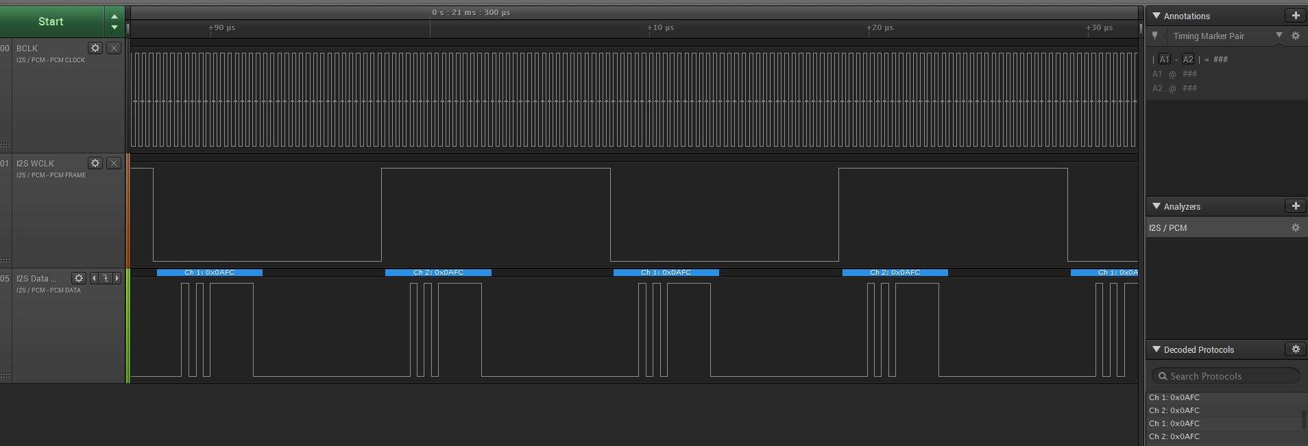

    I'm, following the line to line example, but when I do the same initialization order, I cant get any sound output. I can read back all the registers I am writing, so I2C communication is working. Therefore I assume that the register writing is fine.
    How is the output signal supposed to look like? I'm trying to play a 440Hz sine wave and if I measure the speaker inputs with a scope I get a rectangular signal, is that correct?
  • Hi Roland,
    This is a Class-D amplifier so you should see a PWM at the output (SPKP/SPKM). But it seems that your PWM is not modulating so there is no sound.
    Example 4.0.7 configures the device to 16bits, BCLK&WCLK inputs, I2S mode. Are you providing an input like that?
    Could you share a register dump? This is just to compare and discard a register setting problem.

  • Hi Ivan
    Thanks for the quick reply. I adjusted the specific registers from  the example 4.0.7 so that it fits for my hardware. This includes the BCLK and Frame Sync Direction (set as output). I provide the MCLK from my MCU and have 16 bit wav data from an external flash memory.
    We just bought the TAS2505 Evaluation Kit to rule out a register configuration problem. How does the streaming via USB work? Does the streaming modulate the wav data I play?
    See attached an extract of the .h file with the TAS2505 register settings and the I2S Module settings as well

    We investigated a bit more and the following questions came up:
    We have a .wav file, we play from the pc with the evaluation board and everything sounds fine. We have the same .wav file stored in a external flash memory and when we play it with our hardware and the tas2505 and there is only noise coming out of the speaker...
    the reading from the external flash to the internal buffer does work. the data in the buffer and the .wav file are the same.
    I can see, that the data we are streaming via I2S to the TAS2505 is exactly the same like in the .wav file.
    when we play the .wav file from the pc, the data streamed via I2S isn't the same but somehow modulated it seems. Can you tell me, what happens with the data from the .wav file between the pc and the TAS2505 of the evaluation board?¨¨
    here some screenshots to illustrate what I just wrote:
    Extract of the .wav file data (we replaced some data with 0001 and some with 1010):
    Here what the Logic Analyzer shows, when playing that .wav file above from the pc via TAS2505 Evaluation Board:
    Why is 0001 becoming 00AF?
    Why is 0101 becoming 0AFC?
    Thx, regards
    Roland
  • Hi Roland,
    Sorry for the delay.
    Input I2S data is 16 bit, 2's complement, MSB first.
    I need to take a closer look to the interface between USB and I2S.
    I will be back to you as soon as possible.
    Iván Salazar
    Texas Instruments
  • Hi Ivan
    No problem. Meanwhile we found out, that the data we were sending was little endian. we changed it to big endian and it was working better. we still have a distorted/noisy output but found out, that this is because of a shift/offset when reading from the flash. Because of that we think that some of the data packages are out of sync what results in the distortion...
    We think we are able to solve the problem now.
    thank you for your help
