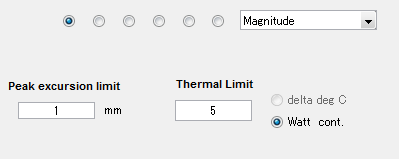

 Please let me know about two point below of setting.
・About peak excursion limit in "SOA" tab, which setting (below①②) is correct?
 ①The speaker rating:15W
 (I think that the spec which is usually submitted from a manufacturer is this.)
 ②The peak output power at Vcc=18.5 [V] @6ohm (about 28W)

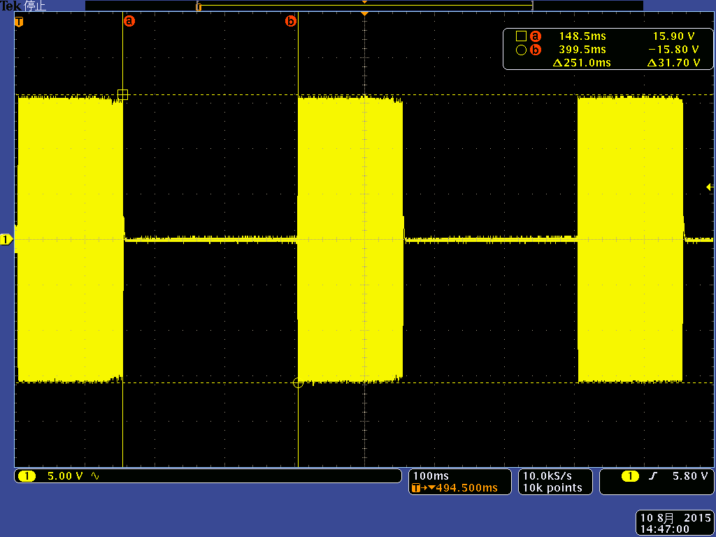

・About Watt cont.(Thermal Limit) in "SOA" tab, It's different from a usual amplifier and even if peak output is applied,
 is there an explanation for the mechanism that a loudspeaker doesn't break?
 For example, please see attached below.
 ※Input to 1kHz sine wave → 150ms peak power  → 250ms no signal → Re-input 150ms peak power →・・・
 Inputting the signal which repeats the above, and when keeping putting peak output in,
 can it be said that it doesn't break down?

  • Dear Don Dapkus-san
    Thank you for reply.
    ・About peak excursion limit, ["PurePath™ Smart Amp User Manual]'s answer is ②The peak output power.
    but slaa627a's answer is ①The speaker rating.
    Which is correct?
    ・About Watt cont, additional information is below.
    When no signal time is less than 250ms, re-input peak power is less than 150ms.
    Satoshi
  • Satoshi-san,
    Power handling (speaker rating) is a stress test performed by speaker manufacturer using pink noise.
    Our thermal characterization relates temperature to steady state power. For example, a 5W tone may heat the voice coil to 100degC after 20 minutes.
    The speaker can be damaged by voice coil or magnet temperature exceeding temp ratings or over-excursion. Instantaneous power does not damage the speaker in itself.
