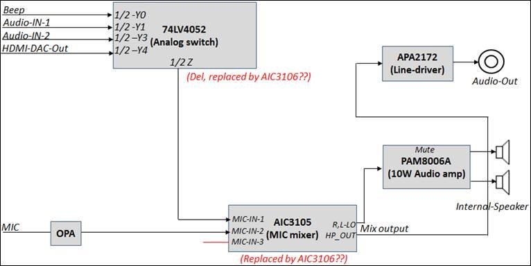

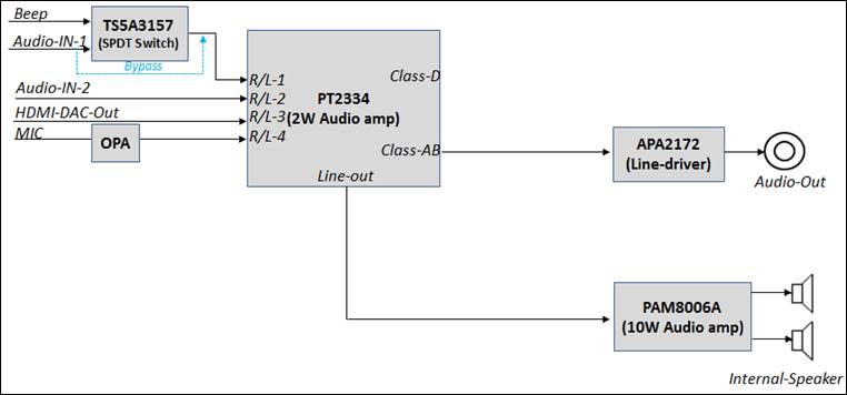

I want to find audio codec for the following specification.
Could TLV320AIC3106 achieve the following condition?
1. 4 audio source input:
(a). Audio Line-in 1 (left、right)
(b). Audio Line-in 2 (left、right)
(c). HDMI audio input (by HDMI DAC output)
(d). Microphone audio input
2.  I have 2 10W internal speaker & 1 Line-out port:
(a). Could Speaker & Line-out stereo output?  And internal speaker & Line-out could be output by OSD at the same time?
(b). Could audio input source mix with microphone,and be output to internal speaker and line-out at the same time?
(c). The microphone volume could be control independently.
Or could you suggest another better solution?
Thank you.
