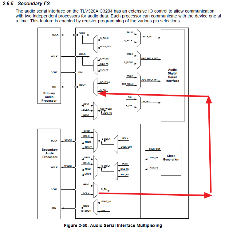

Dear Sirs
I want to set the following red line path.
Could AIC3204 do?
If yes, How could I set the Register ?
BRS

Actually, this path can be configured with page 0 / register 33: Audio Interface Setting Register 6. Bit D1 (Primary Data Out output control) must be configured as 1 to make this loopback.
I hope this helps you. If you still have questions, please let me know.

Dear Sirs
If I only set the following two registers:
Page 0 / Register 31: Audio Interface Setting Register 4, Secondary Audio Interface -0x00 / 0x1F (P0_R31)
D0 (Secondary Data Input Multiplexer) 0: Secondary Data Input = GPIO
Page 0 / Register 33: Audio Interface Setting Register 6 - 0x00 / 0x21 (P0_R33)
D1 (Primary Data Out output control) 1: DOUT output = Secondary Data Input (Loopback)
Does it mean that GPIO is connecting DOUT?
Thank you for your great support.
BRS
Nat
Hi, Nat,
You're right. Additionally, you must configure Page 0 / Register 52: GPIO/MFP5 Control Register to use GPIO input for secondary audio interface (bits D5 - D2 = 0001).
