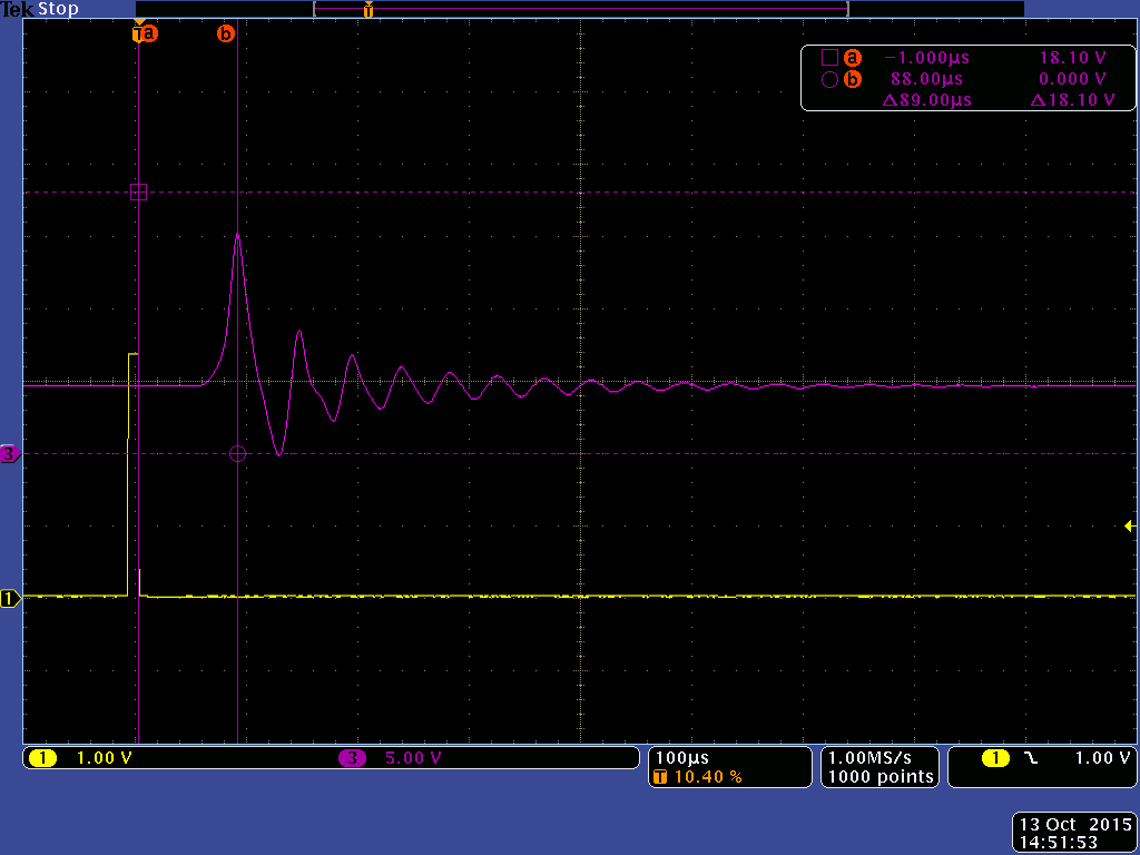

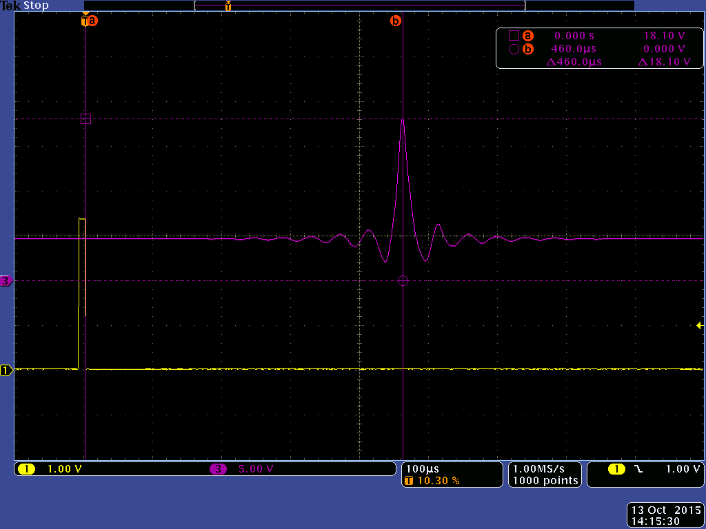

I'm trying to switch to DSP program 7 but get no output (but outputs are switching), can you help debug (register dump attached)?
Switching from program 1 to program 2 is possible and I see the expected impulse responses.
Pics attached, line 1 is I2S data with a single sample, line 3 one amplifier output after filter.
I tried running at 48kHz and 8kHz while keeping master clock at 24.576MHz and 768kHz output switching.
The delay from I2S input to amplifier output is increased 6 times at 8kHz, I guess this is unavoidable?
