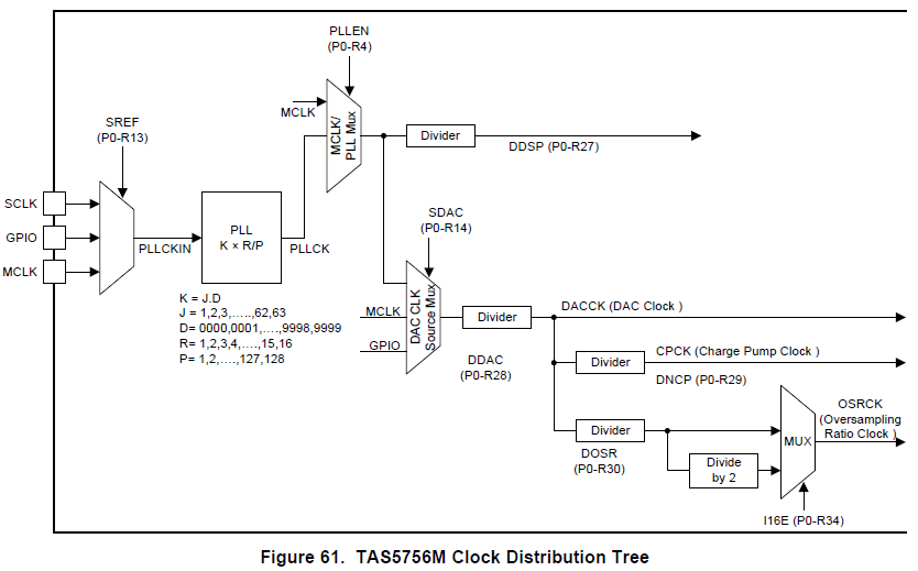

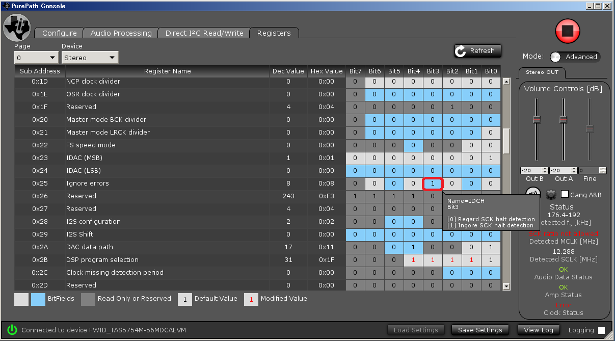

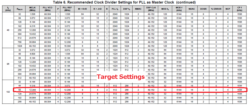

Could you please tell us how to set all appropriate registers for the clock distribution and etc if using 3-wire PCM at the 192kHz processing by using the hybridflow5 ?
The condition which we would like to use is shown as below.
<Condition>
MCLK: Kept the Low Level
SCLK: 12.288MHz
LRCK: 192kHz
SDIN: Stereo 24bit I2S Data
