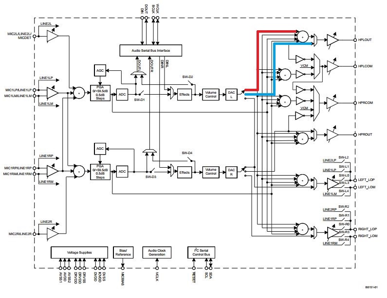

    The noise causes at the TLV320AIC3104 HPLOUT/HPROUT are often related with the register configuration. When the DAC is routed directly to the HP outputs, the output signal use to have more noise. So, we always suggest to route the DAC to the output mixers (red path).
    Additionally, another possible cause could be the out-of-band noise. In order to get a good measurement, it is necessary to add an external filter as the following document mentions: http://www.ti.com/lit/an/slaa313/slaa313.pdf.
    Please, take a look of this document and let me know if you have questions or comments.
