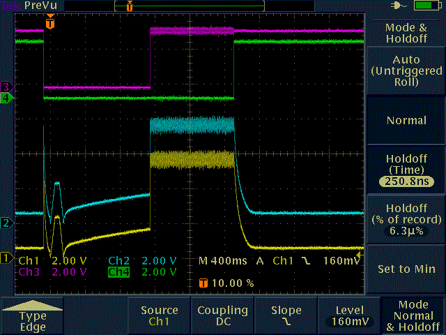

I have a couple of questions about the load diagnostics function in TAS5421.
1). is the MUTE signal recommended to be in any particular state during load diagnostics ?
2). in our application we de-assert MUTE and nSTANDBY simultaneously and we then see 2 cycles of load diagnostics waveform at the speaker connections (waveform as per fig 11 in the datasheet). It then takes approx 1sec before nFAULT de-asserts and audio is enabled. Is this correct ?
Our application is a warning system and waiting for 1sec after the last load diagnostic cycle is far too long. What can we do to reduce this time ?

  • above shows a plot of what happens when we come out of MUTE.
    blue and yellow traces are speaker + & -
    red trace is nFAULT
    green trace is MUTE
    There is one cycle of load diagnostics (sometimes we see 2 cycles) followed by 1sec of what appears to be recovery from fault. Finally we see nearly 1sec of our audio. We can live with one or 2 cycles of load diagnostics but it's the 1sec of silence that follows that we need to eliminate.

  • Nick,
    After a fault as shown in your oscilloscope screen shot, the TAS5421-Q1 will automatically run Load Diagnostics. If the fault is cleared the device will turn on after a delay of about 700ms, and can be as high as 1 second. We have this delay so that the amplifier cannot enter a mode where a fault would cause the output to chatter on and off very quickly.
    I do not understand why it is turning off again in 1 second. Is this induced by you or is it doing it automatically? If is is doing automatically, you need to look for a DC offset on your amplifier. Especially, look at the input pins. Their DC voltage should be the same value on IIN+ and IIN-.
