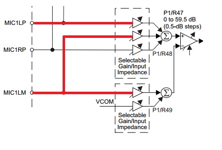

Team,
Customer of mine connects and configure an electret mike as per attached and doesnt get proper function. I checked Hw and it looks good. SW configuration looks ok as per comments but I didnt get into actual register checks.
Can you please advise or provide a reference configuration for electret mike?

  • Hi, O'Mellin,
    I have been checking the register configuration. It seems that customer is routing both differential inputs to the P-Terminal and MIC1LM to M-Terminal. Customer configured the inputs as:
    • Page 0x01, Register 0x30, Value 0x44: MIC1LP is selected for the MICPGA with feed-forward resistance RIN=10k. MIC1LM is selected for the MICPGA with feed-forward resistance RIN=10k.
    • Page 0x01, Register 0x31, Value 0x10: MIC1LM is selected for the MICPGA with feed-forward resistance RIN=10k.
    MIC1LM must be routed only to M-Terminal. So I suggest to configure the registers as:
    • Page 0x01, Register 0x30, Value 0x40: MIC1LP is selected for the MICPGA with feed-forward resistance RIN=10k.
    Could customer try configuring the registers with these values?
    Please let me know if the problem persists.

  • Hi, O'Mellin,
    Could you try enabling the CM input too?
    • Page 0x01, Register 0x31, Value 0x10: MIC1LM is selected for the MICPGA with feed-forward resistance RIN=10k. CM is selected for the MIC PGA with feed-forward resistance RIN = 10 kΩ.

  • Hi, Anthony,
    I would suggest to increase the input gain (Page 1, Register 47). Additionally, I would recommend to try with different processing blocks (Page 0, Registers 60 & 61). Several processing blocks improve the signal quality.
