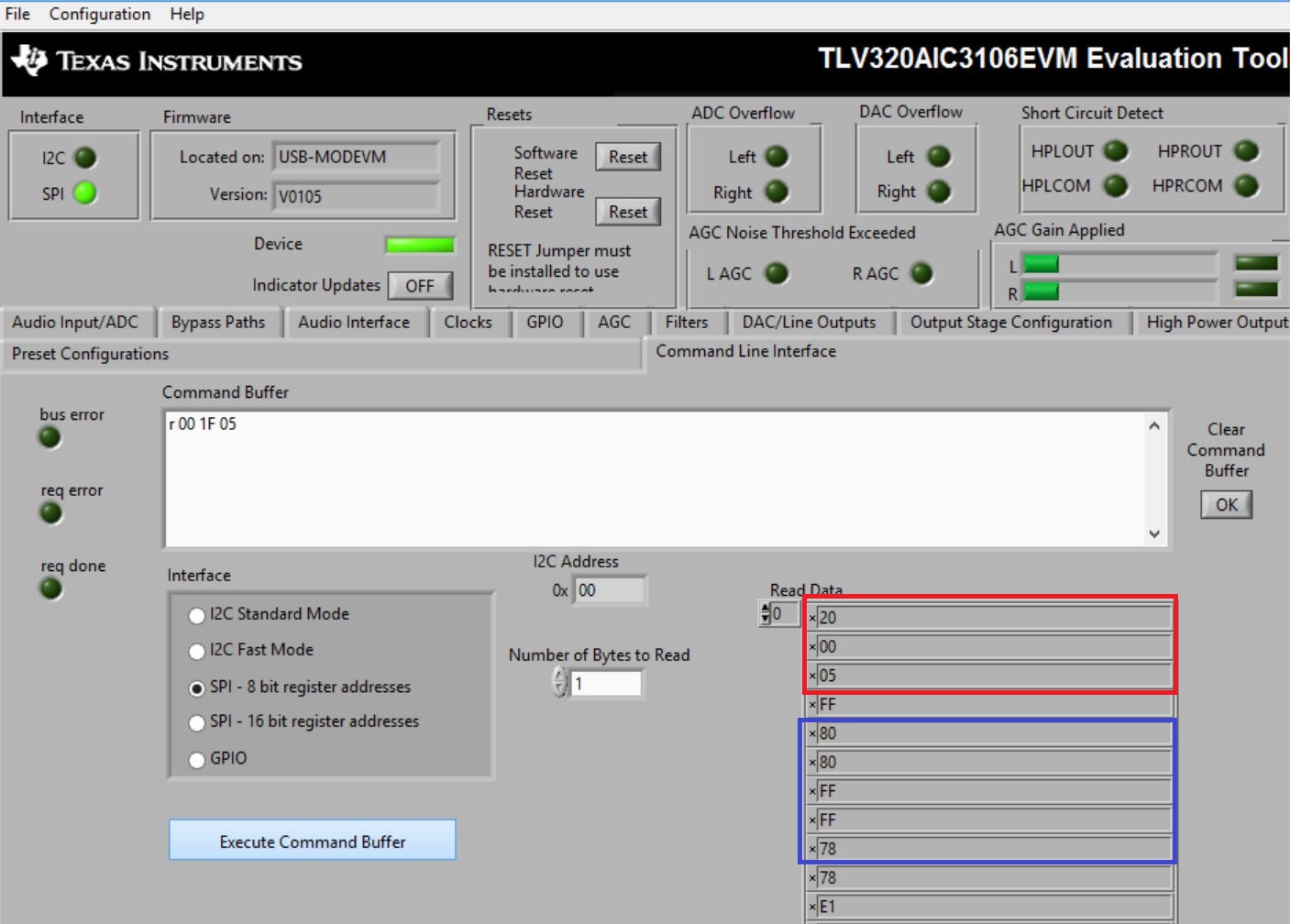

Now for my current problem. How to make SPI configuration working? All example script are in I2C mode. I read the appendix G of the user guide. I tried to write and read the register 00. In the command line interface I tried the following:
i spi8
w 00 FF
r 00 00.
I look into the Read data section, I see parameter commands. Where is the data read? Can you detail more how to use SPI mode ?

    Regarding the read data section, the SPI uses a different format to read data:
    r 00 xx yy : (r - read; 00 - only used for I2C address or MSB of 16-bit address for SPI; xx register; yy data bytes that will be read)
    Note: Remember that the xx register must be written in format ADDR(Bits 7:1) - R/W' (Bit 0). So, if you read the register 0x04, the xx value must be 0x09 (last bit must be '1' for read).
    For example, if you want to read 5 bytes from register 15, the line code would be:
    r 00 1F 05
    Please take a look of the following picture for details. The first 3 bytes (marked in red) refer to the read command and the number of bytes that will be read. Then the bytes marked in blue contains all the data values of the registers 15, 16, 17, 18, 19. They coincide with the default values of datasheet.
    Additionally, you must remember to configure the jumpers JMP10, JMP11 and JMP12 to use the SPI mode. Please take a look of the 2.2.2 TLV320AIC3106 Jumper Locations section for details.
    I hope this helps you. If you still have questions, please let me know.
