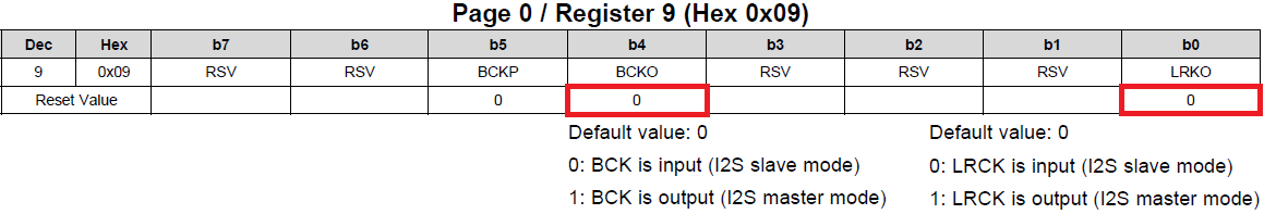

I want to setting slave mode on TAS5766M. I know don't need to modify 0x09 register.

    Default setting is I2S slave mode without any register modification. What is your concern?

    Q2) w 98 09 00 is necessary. Right ?
  • Hi, Jeffery
          Yes,"w 98 09 00" is necessary.

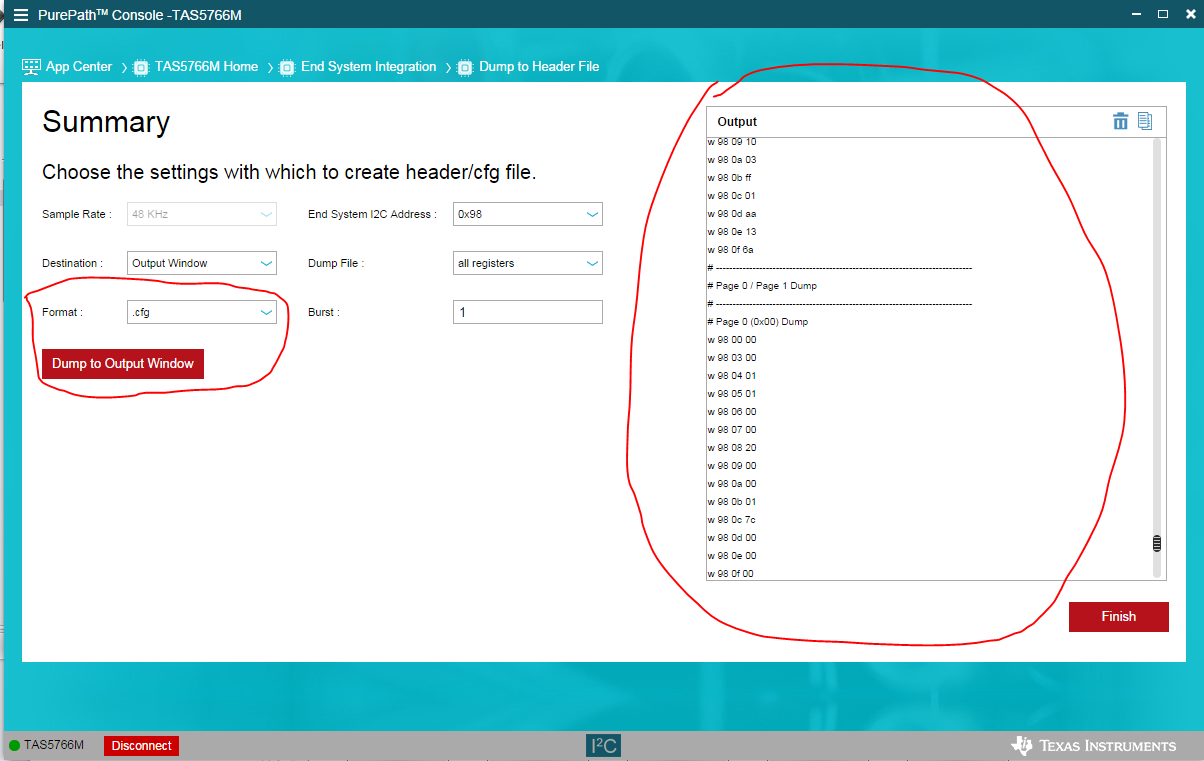

          I suggest you use PPC3's End System Integration/Dump Current State into a header File to generate the .h file or .cfg file.  Because there are many registers in TAS5766,  PPC3 will help to generate the correct configuration file.

    1) With PPC3 GUI, no need to know the content of Page01, Register03, you can get the all the registers value which you need from PPC3 GUI.
