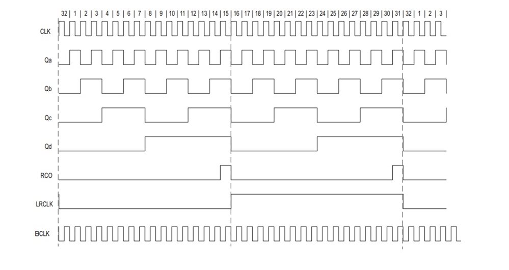

I have previously configured the SPI interface to use a bit rate divider of 0x1F which should yield a real divider of 0x20, or 32.  My input clock to the SPI peripheral should be the SMCLK for the micro which is the same clock being fed to the codec's MCLK.  This clock should be set at something close to 20Mhz.  So, my bit rate on the SPI interface should be 20Mhz / 32 = 625Khz.
So, the "sampling frequency", or the frequency that I should be reading samples out of the codec should be 625khz / 32 bits = 19531.25.
The corresponding setting based on my codec configuration should be setting fsref as 20Mhz / (128/Q) where Q = 4 which yields a value of 39062.5.  I then have the ADC/DAC sampling set to fs/2 which yields the final sampling frequency of 19531.25 which should be an EXACT match to my SPI sampling frequency.  Especially when we consider that both the codec and my SPI port are clocked with the same 20Mhz clock source.  Things should be synchronized.
However, in my input data stream that I read from the codec, I can see "flat spots" in my input sine wave periodically occurring once every 32 samples.  I have no explanation for this.  My SPI ports are all DMA driven so interrupt latency should not be an issue.  By DMA sample size is currently set to 64 samples, so even that doesn't correspond to the precise 32 sample flat spots.  It sure looks like I'm getting out of sync with the codec somehow, but I cannot see where this could be happening.

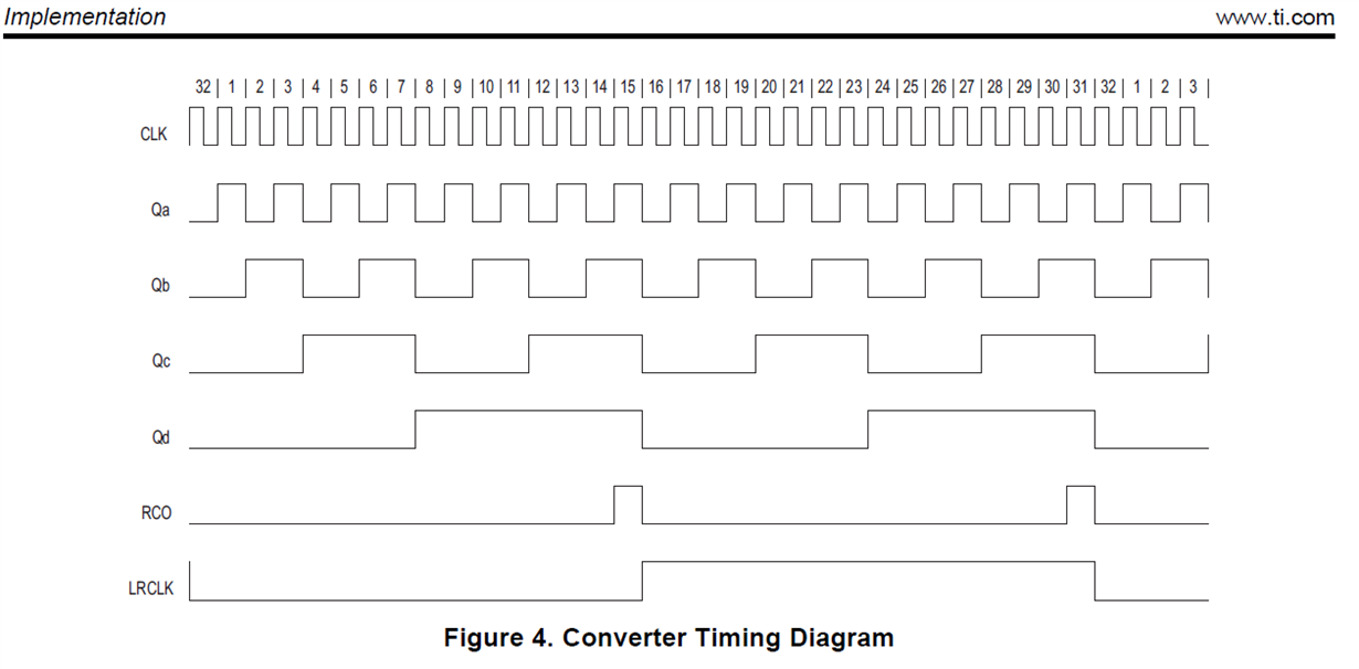

  • Hi Luis,
    I am not entirely sure what you are asking me here. The spreadsheet I supplied, where "Each 32 samples, a value is repeated" is the data I read from the codec. It isn't "input data". I am using a signal generator to generate a 1khz sine wave input to the codec. I then start the codec sampling operation. The data values I sampled are placed in a buffer in memory in my MSP430. I then use my debugger to dump that memory buffer and then import that data into excel. This is the data you see in the spreadsheet. As you can see, once every 32 samples, a value is duplicated. This implies to me that for some reason, the codec outputs the same value on two consecutive samples. As I've been told, and observed in the past, this is generally indicative of a clock synchronization issue. I just don't understand where the synchronization issue could be given the setup of the SPI interface and the Codec clocks as I've previously documented above.
    To me it almost seems like the codec is either dropping or gaining one bit clock for every sample. This would cause my sample to drift off one complete sample every 32 samples which in turn would cause the duplicated data sample. I just don't see how this could be happening.
    Chris.
  • Hi, Chris,
    I apologize for the confusion. After check your last information, I suspect that the problem could be related with the WCLK (LRCLK) generation. Every 32 samples, a value is duplicated. Probably this means that there are 33 bits per WCLK frame. This additional bit could be generating an additional value every 32 samples. Have you checked both clocks (BCLK and WCLK) with an oscilloscope? Have you checked if the number of pulses is correct?
    Luis Fernando Rodríguez S.

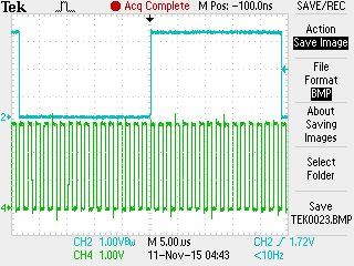

  • Hi Luis,
    Yes, that is exactly what I checked.  I put my scope on BCLK and WCLK.  Here is what it looks like:
    By my count, it looks like exactly 32 BCLKs (Green) for the WCLK cycle (Blue).  16 bclks in each half of the WCLK.
    To my eye, this waveform seems to match exactly the waveforms described in the SLAA449A app note.
    Chris.

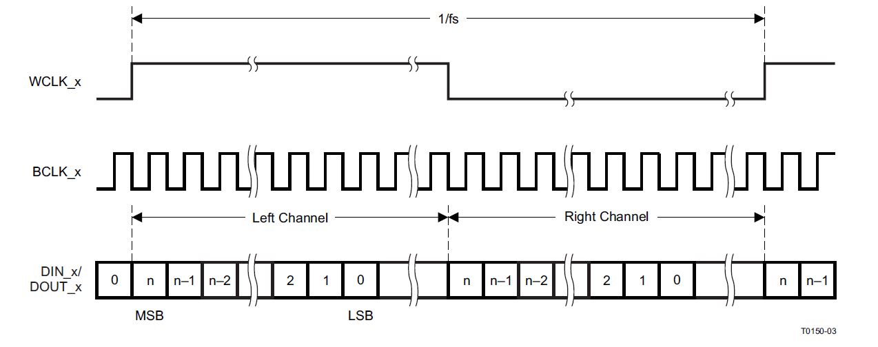

  • Hi, Chris,
    I have been checking your information with my colleagues of the audio team. First, we noticed that the BCLK and WCLK have some differences with the timing diagram of the datasheets. In left-justified mode, BCLK falling edge must match with the WCLK rising edge as the following picture shows:
    In the last picture that you sent us, it seems that your BCLK is inverted (both rising edges match). Could you try inverting the BCLK signal, please?

  • Yes, I noticed that clock inversion / discrepancy before as well when comparing my trace with the tlv320aic34 datasheet for left justified mode.  However, the clocking matches EXACTLY the waveform that was published in the SLAA449A app note.  Specifically, in this snippet, you can see the WCLK changing synchronously with the rising edge of BCLK:

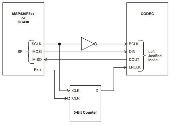

    I've been considering your request to invert BCLK and it isn't clear to me exactly where you'd like the inversion to be made. Please refer to the SLAA449A app note circuit and it's connection to the MSP430's peripheral. There are things that can be done with the SPI Clock phase and polarity via MSP430 register manipulations to change the relationship of the clock edges and how data is presented or sampled on the interface. If you could possibly describe in detail how and where you would like the inversion to be made, I could work with my hardware designer to manipulate circuit and/or I could modify the MSP430 register configuration. However, I need more to go on that just "Invert BCLK".
    Also, I find it troubling that in the TLV320AIC34 datasheet that the only waveform / timing diagram listed where the different modes (Left-Justified, Right-Justified, IIS, and DSP) that doesn't have "extra" bclks" between the Left and Right data is the DSP mode. All the other modes always seem to show additional BCLK clock cycles between the LSB of Left and MSB of Right channel data. I don't know if this was intentional, or if this was just they way the diagrams were drawn.
    Please let me know as soon as you can how and/where you'd like the BCLK inverted.
    Chris.
  • Hi, Chris,
    We suggest to add an inverter between the SCLK output and the BCLK input as the following diagram shows:
    This connection will ensure that the BCLK will be inverted:
     I'm confusing about why this app note recommends to use the BCLK in that way. The Figure 1. I 2 S/LJF/RJF Timing in Master Mode specifies that the BCLK falling edge must match with the falling/rising edge of the WCLK. So, we expect that this test will improve your sampled signal. Is it possible for you to invert the BCLK in that way?
