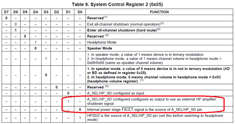

Hi Kato-san,
Your Assumption is correct, in order to monitor /FAULT signal on A_SEL/HP_SD pin you need to configure the pin as output (D1=1) and select /FAULT as the source for the pin (D0=0).
-Diego Meléndez López
Audio Applications Engineer
Hi Diego-san,
Thank you for your quick reply.
I have an additional question.
So, I believe that this internal power stage /FAULT signal is transited from the low level to the high level similarly since TAS5717 automatically returns to normal operation once the fault condition is removed.
Is my understanding correct ?
Kato
Hi Kato-san,
Yes, /FAULT signal follows the fault status of the power stage.
