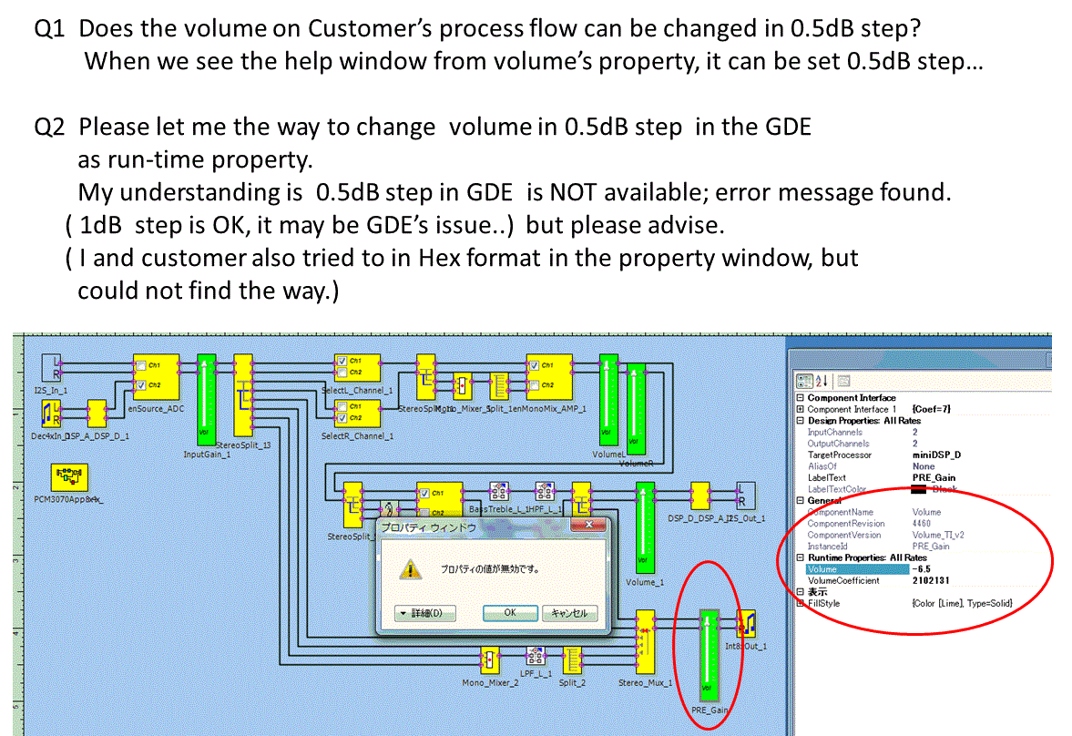

Q1  Does the volume on Customer’s process flow can be changed in 0.5dB step?
When we see the help window from volume’s property, it can be set 0.5dB step…
Q2  Please let me the way to change  volume in 0.5dB step  in the GDE   as run-time property.
My understanding is  0.5dB step in GDE  is NOT available; error message found.
   ( 1dB  step is OK, it may be GDE’s issue..)  but please advise.
  ( I and customer also tried to in Hex format in the property window, but        could not find the way.)

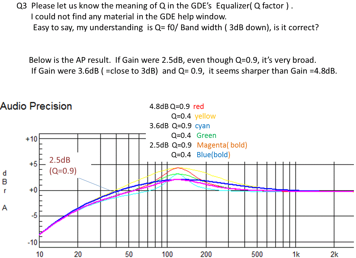

Q3  Please let us know the meaning of Q in the GDE’s  Equalizer( Q factor ) .
    I could not find any material in the GDE help window.     Easy to say, my understanding  is Q= f0/ Band width ( 3dB down), is it correct?
   Below ( attached ) is the AP result.  If Gain were 2.5dB, even though Q=0.9, it’s very broad.
    If Gain were 3.6dB ( =close to 3dB)  and Q= 0.9,  it seems sharper than Gain =4.8dB

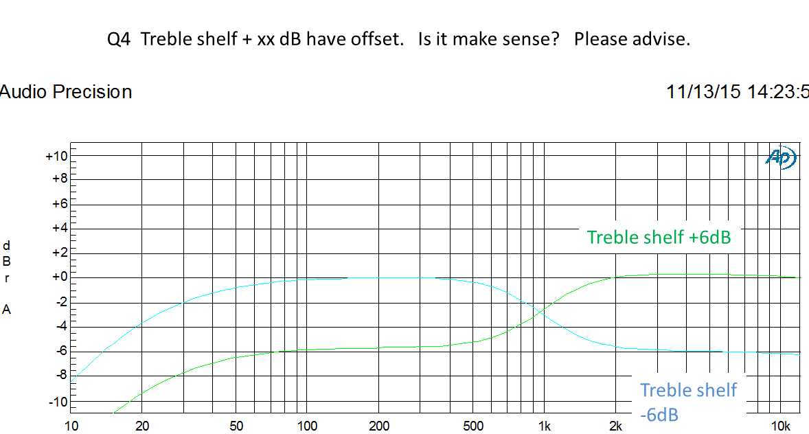

Q4  Treble shelf in + xx dB have offset.   Is it make sense?   Please advise.
    I think that the help window has a mistake on the accepted volume values. The volume block cannot be changed in 0.5dB steps. I tried with different EVMs and the volume block shows an error when the volume is not configured as an integer. This block only accepts integer values from (-110dB to 6dB).

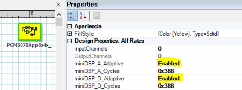

    As I already explained in Q1, the volume cannot be changed in 0.5dB. However, if you want to change the volume in GDE as run-time property, you must configure the miniDSP_A and miniDSP_D in adaptive mode.
    The Q factor is the relationship between cut-off frequency and bandwidth at 3dB down as you already mentioned (Q = fc/BW). I noticed that in your first graph, you configured Q as 0.9 and 0.4. However, the correct range is from 1 to 10. Probably, there are some discrepancies in your example because Q is not in the correct range.

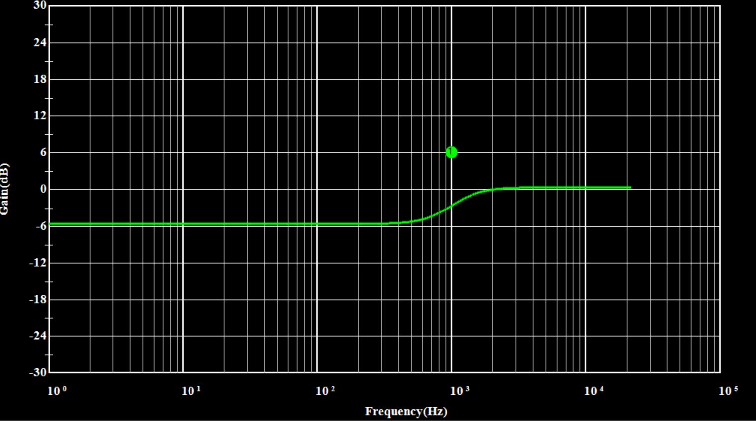

    Ideal filters are shown in the following pictures:
    • Treble shelf filter, fc = 1000Hz, 6dB.
    • Treble shelf filter, fc = 1000Hz, -6dB.
    In your second graph, it seems that there are an additional high-pass filter added to the shelf filter. So, the real filter could show some differences such gain or phase. So, it make sense.

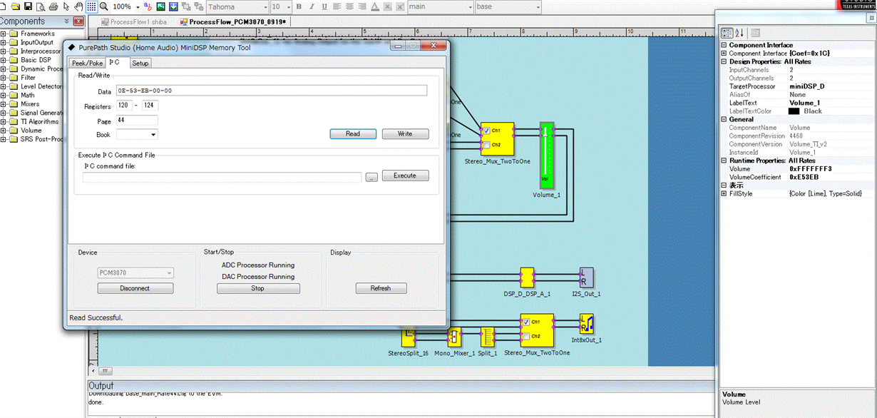

     The volume component can not be set  as 0.5dB step in the GDE run-time  property,
     but,  via following step,  customer can  set 0.5dB step in the GDE.
    * 1  check the  page and i2c address from  component interface overview window
    * 2  tools=> i2c memory tool => i2c read/write
    *3    write the  HEX value to the its page and  i2c address directly   in 0.5dB step.
  • Hello, Shibatani-San,
    That's correct. I could change the volume in 0.5dB steps with the I2C memory tool as customer mentioned. Probably, the GDE doesn't accept these values but the miniDSP can change the volume in 0.5dB steps as the Volume help window explains.
