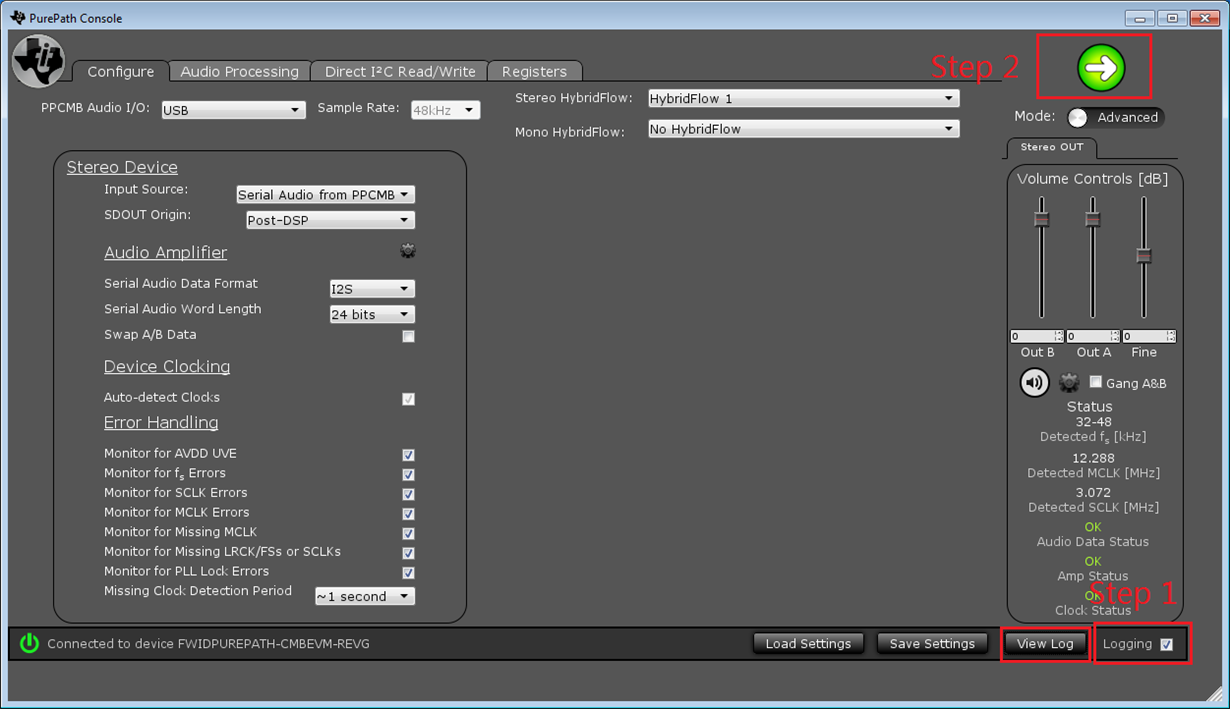

  • Hi Kato,
    Basically,  you have two options  to figure out the minimum register  configurations required.
    a)  Use a sniffer device to dump the communications on the i2c bus.
    b)  Make use of the logging feature in the PPC2.
    Let me explain more on the second option.
    Step 1:  Enable logging in the PPC2 as the figure below shows and then click the "View Log" button.  Click "Clear" button on the bottom in the "Log Viewer" window to make sure you have a clear starting point.
    Step 2: Click the "Download" button and wait for the GUI to complete the downloading.
    Step 3:  Click the "View Log" in the PPC2 again and copy all the contents and save them to a text file.
    Step 4:  Remove all the irrelevant writes and you will get the minimum register configurations. For example, in the figure below all the writes not for the target device (0x98) are irrelevant and they should be removed.
