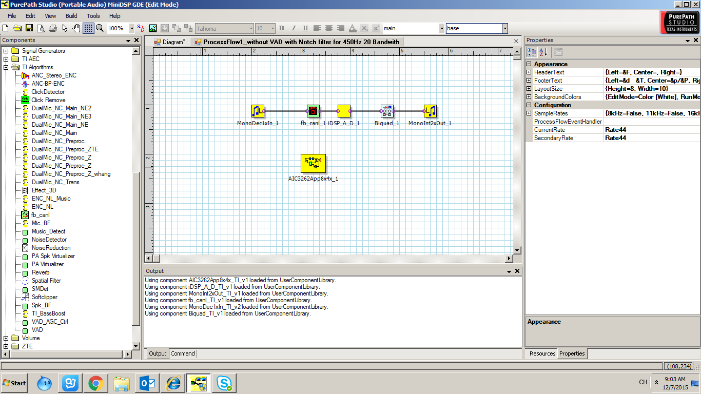

I used algorithm "fb_canl_1" in PPS which is dedicated to AIC3262, this algorithm performs acoustic feedback cancellation by using adaptive notch filter.
In PPS I generate code(.h file for MCU config the aic3262) and revise some parameters for my application, and then I run the code in MCU,  soud can be applifiied. but when the microphone approach the loudspeaker, the howing still exists, the algorithm did not work well.

  • Hi Luis,
    The version of PPS I used is 5.95 build 1 revision 35815 and component library version 6738.  the "fb_canl" is in the file of "TI algorithms". It is dedicated to AIC3262. As the following picture is my algorithm design:
    help file:
    please help verify it that how the algorithm can work well? and how about its performance?

  • Hi, Kevin,
    It seems that the algorithm is not common on PPS. I downloaded the same version of PPS and it is not included in component library. Could you provide the component algorithm from the ComponentLibrary folder of PurePath Studio (Portable Audio) MiniDSP 5.95 folder?

  • Hi, Kevin,
    I was looking for more information about this block.
    I apologize, unfortunately the noise cancellation, echo cancellation and reduction components are not supported anymore. This feedback canceler was removed with all those components and we are not giving support anymore.

  • Hi, Kevin,
    Our codec miniDSPs don't have enough memory capacity to support these algorithms. They cannot do that function due to this limitation. So, it was decided to remove this component.
    Is it possible to replace this algorithm with the PPS blocks? I mean, could you recreate a similar algorithm with the rest of the blocks in PPS?
