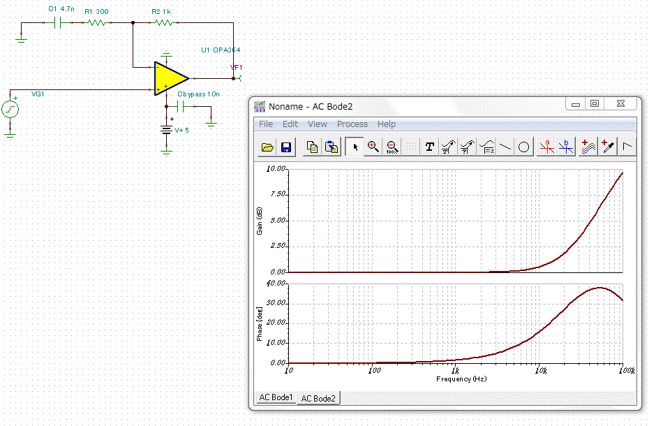

My customer is using PCM3070, but they hope flatten frequency responce for next model.
Here I attach the PCM3070 EVM _ frequency responce which is  fs=44.1K below.
Customer says WM8998 (CODEC w/miniDSP) is our competitor, and they are evaluating .....
*** Need your help ***
Please advise how to improve this. Post-filter is recommended? ( Ihad already said it  customer,  )
Otherwise, do you have another recommended CODEC with mini DSP ( fs=192KHz max ) whose freq. responce is better ?

    I did not got your responce yet, but  my customer says my suggestion :post-filter,  is not smart, and they can not accept that .
    My Customer is now evaluating WM8998 for next year model because its frequecy responce is  so flat  compared with PCM3070
    , as per customer's evaluation.
    I will suggest customer  to use PCM5142 ; DAC with miniDSP in place of PCM3070.

    Customer hope flat responce  as 20-20KHz at fs=44.1KHz  from DAC output ( i.e. ADC- miniDSP( BQ filter is off course, All path)-DAC output).

    Sorry about the delay, I was out of office last week. The PCM3070 has a miniDSP that is capable of using programmable biquads, created in PPS to apply filters to the audio signal. I believe it would be possible to make a flat response with the use of a biquad or two. This ability would also be true for the PCM5142 or PCM5242.

  • Dear Justin san
    Thank you for your anrwer.
    It seems smart.
    I will discuss with customer again.
