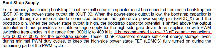

TAS5624A Recommended Bootstrap Capacitor
Could you please tell us the concern if increasing the capacitor value more than 0.033uF although the value which you recommend is mentioned on page 14 of data sheet regarding the bootstrap capacitor ?

    The bootstrap capacitor value is a balancing act between charge storage and charge time.
    If the bootstrap cap is made too large, the charge time will be slower so that it won’t charge to the full value of GVDD_X when OUT_X is low. Then when the OUT_X transitions high, it cannot keep the high side FET on and the FET prematurely shuts off.
    If the bootstrap cap is made too small it will now quickly charge to the full GVDD_X voltage when OUT_X is low. However, when OUT_X is high, It discharges too fast when driving the gate of the high side FET and the FET again shuts off prematurely.
    33nF has been found to be the best value for this device.
