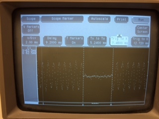

The output from the '3104 has a dead band/area/gap that is ~5ms wide and repeats every ~85ms (12Hz).

The signal is active/dead for ~3844/252 periods (o-scope measurements) - 3840/256 more likely.
Can't be sure as signal returns to zero - could be forced by DAC vs data.

Same results with 48k or 8k sampled signals. Used 1KHz test tone pattern/file, and the portion that shows up appears to be at freq.
