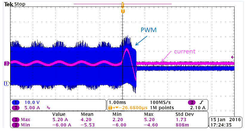

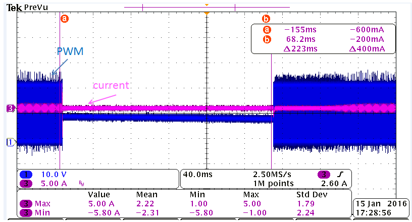

    They have an additional question about OC fault.
    When OC fault occurred, how does TPA3121D2 operate?
    Toshi
  • Hi, Toshi-san
           I will update the ripple current test result to you next Monday.
           For Over current protection behavior: when the current increase to OCP point, the output stage will come into Hiz.
    After the Over current event, the driver will keep in Hiz about 220ms, then will switching again. This behavior will continue until the short been move away.
