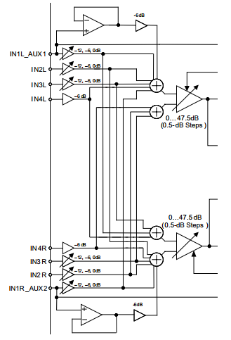

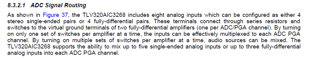

    So the engineer also raised a question that there are 3 analog audio ports ( I assume for mixing ). I was looking at the data sheet and came across the final sentence in the image below highlighting that the CODEC supports the ability to mix up to 5 mono or 3 stereo (differential signals) going into each ADC PGA channel. Does that mean in total it can take in 10 mono or 3 differential signals between the two PGAs or is it just 5 mono/3 differential signals for the combined PGA's?

  • Hi, Javier,
    You're right. The Codec has the ability to mix up to 5 mono or 3 stereo per channel. This can be verified on the AIC3268 functional block diagram:
    As you may see on the picture above, each PGA can receive up to 3 stereo signals or 5 mono signals (IN1R/L inputs have two different ways to be configured, so there are 6 lines connected to one of the PGA mixers).
