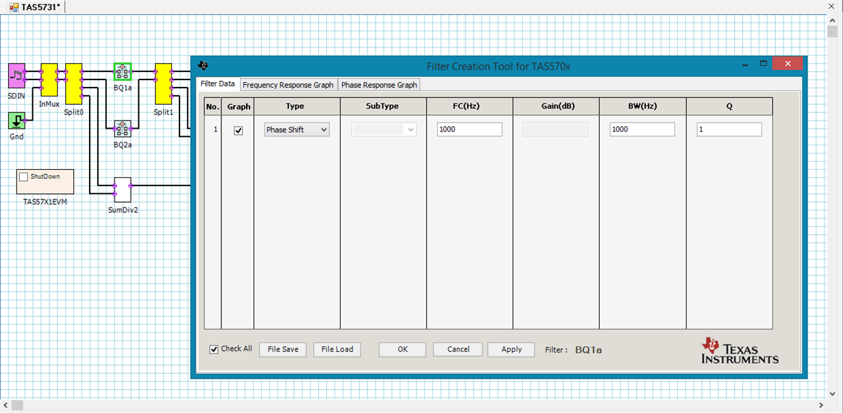

Is there any way to invert phase signal with 0x51 or 0x52 levels? (I see default is 0x00800000, maybe something like the complement?)
many thanks

    Pre and post scale of the TAS5731M can be controlled via registers 0x57 and 0x56. The values for these registers are 26-bit coefficients using a 3.23 and 9.17 number format format respectively. You can find more information about how to calculate the coefficients on page 40 of the TAS5731M datasheet.
    The phase can't be inverted with pre or post controls, but you can use one of the biquads available for each channel as a phase shift filter.

  • Hi, Eden,
    This is quite simple with our TAS5731M GUI. You just need to open the Filter calculation tool by double clicking any biquad, then you just need to select the phase shift filter from the Filter type column.
    The GUI can be downloaded from the TAS5731M EVM product folder on ti.com.

  • Many thanks Diego! (I had never used the GUI, just calculated biquad values by myself !)
