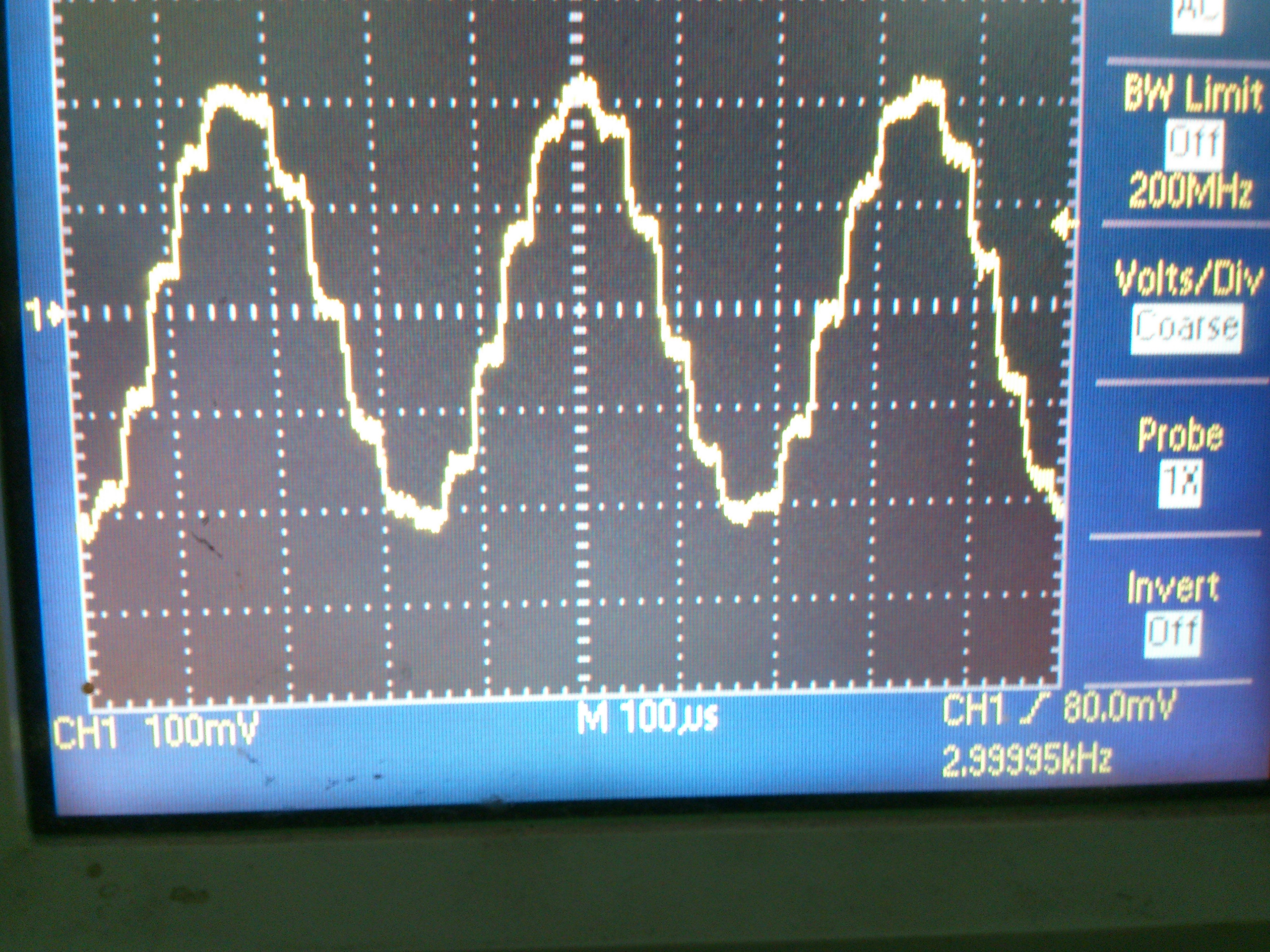

Hello.
I have TLV320AIC3204EVM-K. I am connect externally:
MCLK = 24.576MHz
BCLK = 512KHz
WCLK = 8KHz
Audio Interface = I2S
Data Word length = 32 bits
Digital Loopback  mode.
J1= sine wave 3KHz /150mV RMS.
Clock/Interface setting the next:
On J6 I have the next signal:
I have approximately 12 samples for period.
Fs = 3KHz * 12= 36KHz
I don't understand why I have only 36KHz sampling rate after interpolation dac.
As far as I understand Fs must be the next:
6.144MHz / 32bits = 192KHz.
Script file is attached.

I am hope for your help.
