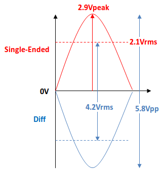

  • Hi Murugan, Justin,
    Your discussion is really helpful for me to understand the input specification.
    Here I prepare quick drawing with regards to input swing specification.
    Please correct me, if I'm wrong.

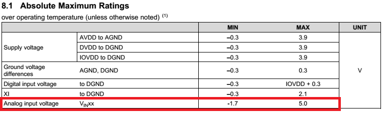

    But I have another question. We have the absolute max specification in the datasheet as below.
    I'm concerned that if we have 4.2Vrms(5.9Vpp) swing, it seems out of specification.
    Ken
  • Hi Ken !
    We are also working on a project based on this chip. And we are asking ourselves the same questions !
    We assume that Analog input are biased at Vref, i.e. 0.5xVCCA as stated in the datasheet. So 1.65V. This will mean that your sinus schematic should not be centered to 0, but +1.65V. It will lead to a positive swing of 5 - 1.65 = 3.35V, and a negative swing of -1.7 - 1.65 = 3.35V too ! And this works with Max input of 2.1Vrms that is equivalent with 3Vpeak.
    Question for Justin (or any TI FAE) : are Analog Inputs really biased to VREF pin ?? If so, we could bias a front-end AOP using VREF pin, allowing to remove DC-Bloking capacitors, right ?
    Will appreciate your answer on this topic.
    Thanks !
    Antoine.

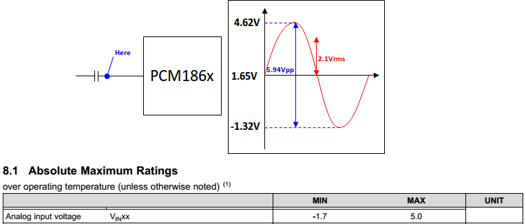

  • Hi Antoine,
    Thank you for sharing information with me. It helps me to understand.
    Here, I modified my drawing a bit based on the dicussion with TI separately.
    As you can see, the peak-to-peak voltage range can be calculated with
    2.1Vrms x 2root2 = 5.94Vpp. Since offset is VDDA/2 = 1.65V, the high peak is around 4.62V, then the low peak is -1.32V.
    This is what PCM1862 can accept without any distortion.
    However, you may think, this range is outside of power supply range. I fully agree.
    As for this, TI cannot disclose the details (see discussion above.)
    (However, it's still within the absolute max range.)
    Hope this help.
