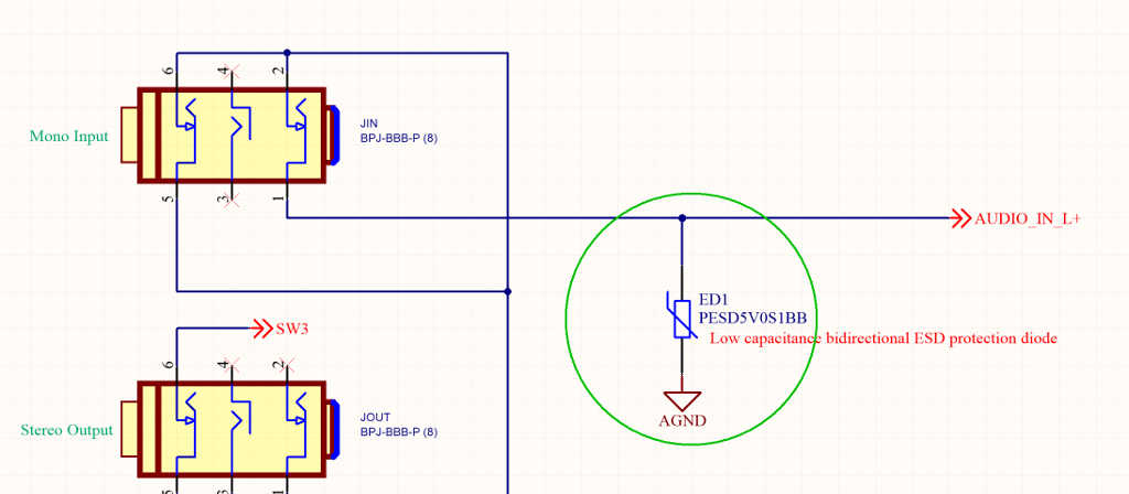

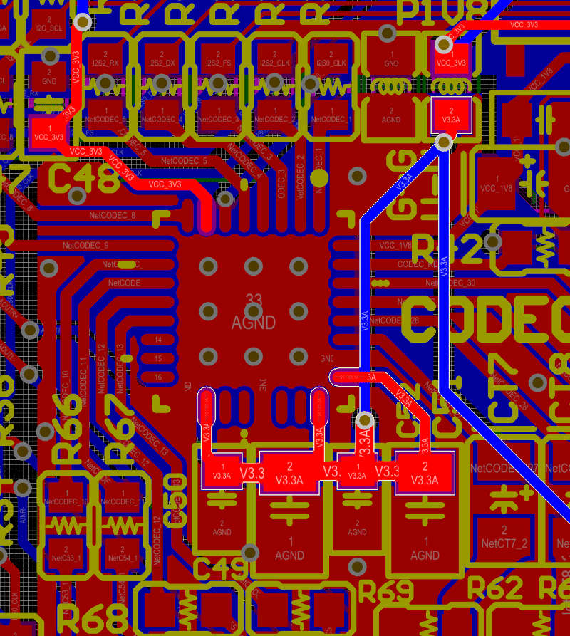

Hello, I'm in the problem that the ground bounce due to ESD event resets TLV320AIC3104.
Almost everytime ESD event reset the codec, so all outputs are muted.
I couldn't find  a solution for reducing this side-effect,
because I think it's not possible to solve it with ESD protection part such as TVS diode, varistors.
How should I put the ESD protection parts?
Any suggestion would be appreciated.
