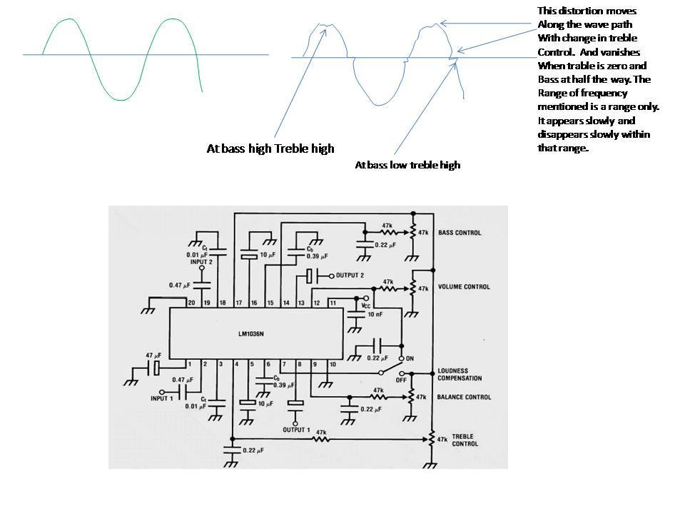

  •  Hi Ivan,
    I am attaching the wave form and circuit as a jpg image.
    One point I forgot to mention that the Zenor Voltage level is 5.59 V as it is coming instead
    of 5.4 V as in data sheet. Distortion is something like crossover distortion which moves
    along the waveform from peak to crossover point. Its like a notch in the waveform.
    (1) When Bass & Treble both high -- Notch is at both the peaks which folds the wave.
    (2) When Bass min & Treble high ---  Distortion reduces a little and shift along the wave.
    (3) When both treble and Bass is low -- Distortion disappears. Waveform is crystal clear.
    (4) Actually at this range of frequency there is 0db gain, so there is no change in gain observed.
    Please suggest.
    Debasis Debnath

  • Hi Debasis,
    What is your input level? Have a look at the "Signal Handling" section of the data sheet. Are you going outside the values shown? The data sheet uses 0.3Vrms (0.8485Vp-p) for their tests. The input level is tied to the settings of the tone controls; I'd be careful not to exceed the ~1Vp-p level.
    In looking at the schematic for the device, the AC Bypass is brought out. They show a 10µF cap; I'd also put a 0.1µF ceramic cap in parallel with the one shown. I also don't see any harm in making the 10µF bigger...
    Mike T.

  • It sounds to me like it's oscillating, which kind of follows from the signal diagram you drew. Did you look at the decoupling and AC bypass? I'd put a scope on the AC bypass pin and monitor that as you sweep the input frequency.
    It doesn't help you with this device, but it was pointed out that this device is EOL. A couple of opamps and a handful of discrete components and you can reproduce what this IC does...
    Mike T.

  • Hi Mike,
    Out put device is an Oscilloscope 20MHz Scientific.
    Mike, the problem is resolved today at 4 pm. Sorry the problem
    was at my end -- it was two folded issues.
    (1) The out put of the signal generator had some problem. But the input
        (whatever it maybe -- sine in nature) should be reproduced at the
        output. I fine tuned the generator -- problem reduced.It stopped at
        cross over distortion level. Top folding vanished.
    (2) Actually I used C_bass 220 nf and C_trable 20 nf. I changed the value
        of C_trable by 10 nf and distortion reduced drastically.
    Now I may change C_Bass to 390 nf -- Thinking. As such no issue.
    But would you please tell me whether this IC can handle any signal (other
    than sine) in the prescribed range of 20 Hz-20 KHz @ max 300 mV level.
    Please give your comment.
    best regards,
    Debasis Debnath
