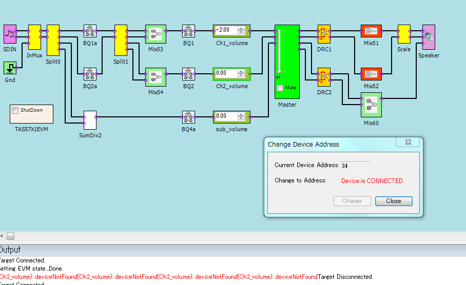

  • Hello Diego-san,
    I confirm the operation by using the PPC1_GUI.
    The results were operating without problems.
    Then check the operation along the Userguide in TAS57xx_GUI.
    However, the following error message will be displayed.
    (Master): deviceNotFound(Master): deviceNotFound(Master):
    My customer wants to both GUIs.
    Please tell me the advice of when to use both.
    Y.Hasebe
  • Hi, Hasebe-san,
    The message you are getting often is caused because the GUI can't find a device with the correct I2C address. Can you please verify that the GUI you are using is the TAS57x1 GUI?, the TAS57xx GUI is used for other devices that have a different I2C address, so maybe that is the issue. If you are using the correct TAS57x1 GUI and still have this issue, then you may need to change the I2C address on the I2C Memory Tool of the TAS57x1 GUI that can be found in tools section.
      -Diego Meléndez López

  • Hello Diego-san,
    Thank you for your reply.
    I'm sorry to mistake GUI name.
    I use TAS57x1 GUI.
    Then I check  Change Device Address.
    At first  address is  "34" ,then there was  indicated error message.
    Next I was confirmed by changing the address to 36.
    (I changed the system also "36" on the PC.)
    The result was the same error message.
    Do you have any other information?
    Best  Reagards,
    Y.Hasebe
  • Hi Hasebe-san,
    Thanks for the clarification. The address for the TAS5731 is 0x34, I verified in my EVM that the error message shows when a different address is selected and when 5V power supply of the MC57xxPSIA is not connected. Can you please verify both conditions on your setup?
       Audio Applications Engineer

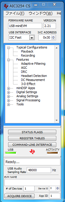

  • Hello Diego-san,
    I checked set up of EVM and GUI.
    1. 5V power supply  : OK
    2.address for the TAS5731M : 0x34
    However , still get an error .(below message)
    Then I check the Status in the GUI of AIC3254 CS as another way. (See figure below)
    Do you have any information?
    Y.Hasebe
  • Hi, Hasebe-san,
    Thanks for the information. By looking at the AIC3254CS, I think that perhaps the MC57xxPSIA board  has a different FW programmed. Can you please refer to this post and re-program the MC57xxPSIA FW and verify if this fixes the issue?
    Have you tried using a different MC57xxPSIA board?
  • Hello Diego-san,
    Thank you for your replt.
    ⇒ I have already done, but it was indicated same message.
    ⇒No, I have only 1 EVM.
     I have used same EVM.
    Once again shown below the EVM setting as the operation check conditions.
    1. Implement the Firmware setting(DFU_TEST) I got from you.(use USB-miniEVM0221_441KHZ.BIN)
    2.Operation check in PPC1.16.
       ⇒OK
    3.Next, remove all connection.
    4.Start the USB and power connections to TAS57x1_GUI.
     ⇒Error Message
    TAS57x1_GUI  doesn't  have fs=44.1kHz.
    PPC1.16_GUI has 44.1kHz.
    Then my customer wants to use both fs(GUI).
    Could you please give me information.
    Y.Hasebe
  • Hi, Hasebe-san,
    Thanks for the explanation. If I understand correctly, you are programming the MC57xxPSIA  board with the USB-miniEVM0221_441KHZ.BIN file right?, this is not correct. You need to program the MC57xxPSIA with the files indicated in the Wiki page mentioned in the post I pointed before.
    The interface between the TAS57x1 GUI and the MC57xxPSIA motherboard requires adequate firmware file (EEPROM.bin).
  • Hello Diego-san,
    Thank you for you reply.
    Probably, my customer and I used USB-miniEVM0221_441KHZ.BIN file.
    So we will try to use MC57xxPSIA with the files in the WIKI page.
