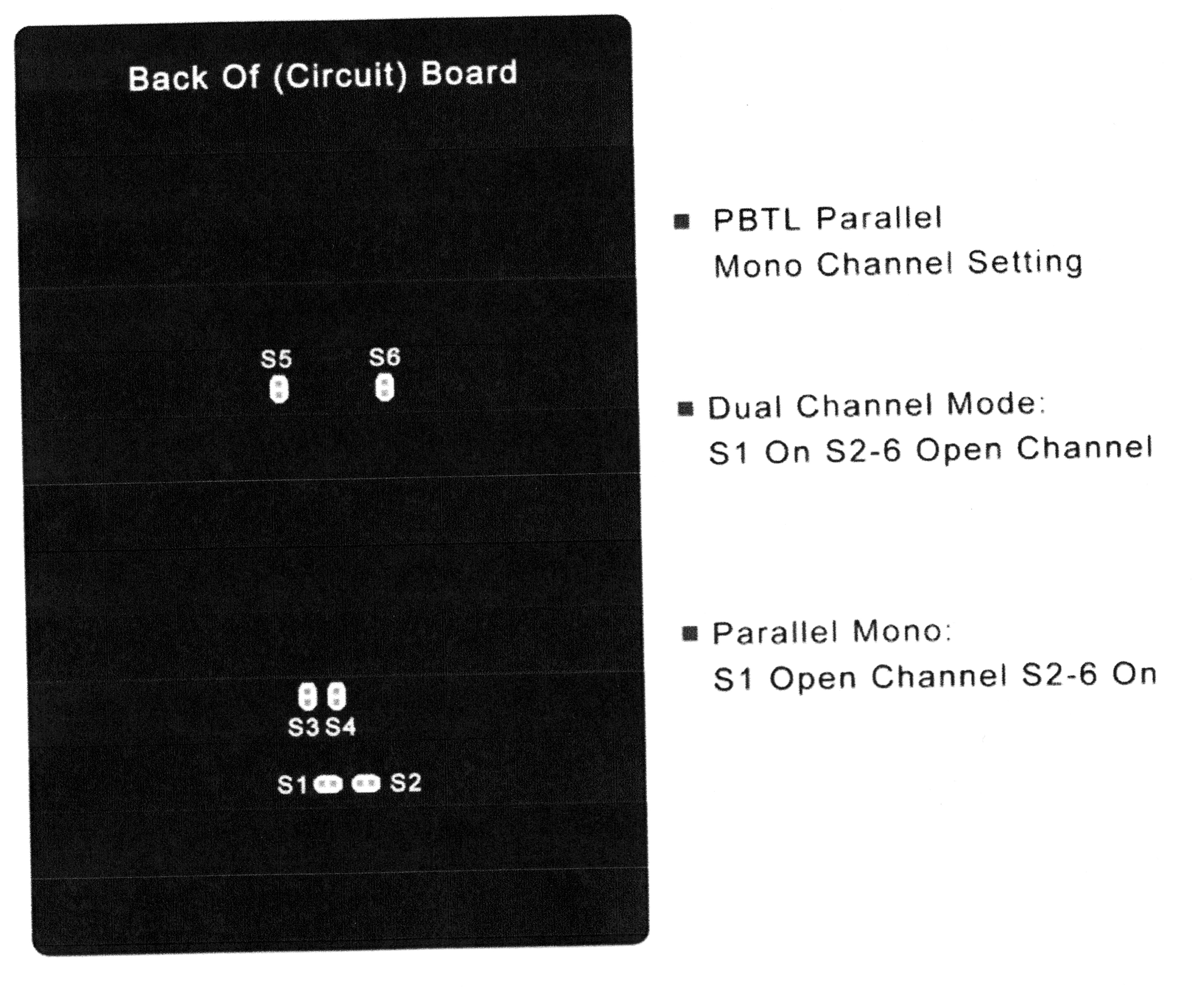

Hi - I just purchased a TPA3116D2 from Amazon PRODUCT LINK that I want to convert to MONO
FYI: My actual QUESTION is at the bottom of this posting
On the back is this PBTL TABLE in Chinese     can someone send in English ??
Also, included with the product was this image of the back of the PCB
QUESTION:
Would someone kindly (a) translate that Table and/or (b) tell me what soldering I need for Parallel Mono:
I am confused with the terms OPEN and ON.
Am I right to assume that S1 Open Channel S2-S6 On
really means                      S1 No Solder         S2-S6 Should be soldered / jumpered  ??
Thanks ... I'm a retired Industrial & Computer Engineer, not an Electrical Engineer !
So please be kind - I'm not at all familiar with this terminology [or Chinese for that matter]
Best regards & thanks in advance,   Jim

               Welcome to e2e! You are correct.
    really means                      S1 No Solder         S2-S6 Should be soldered / jumpered.
    "Open" means "No solder" or "do not connect"
    "On" means "Solder" or "connect"
    I have translated the Chinese table in to English, but I think image of the back of PCB shows the same content of this table.
