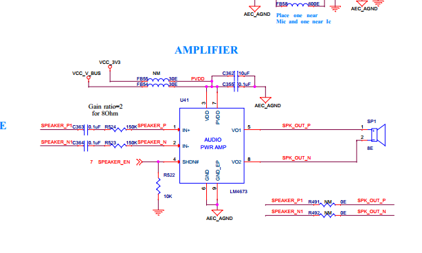

I am using LM4673, with this 8E speaker is uesd.
When I am playing 1Khz sine wave audio file, in starting volume level is good but after 3 sec volume get decreased and it is constant upto end.
