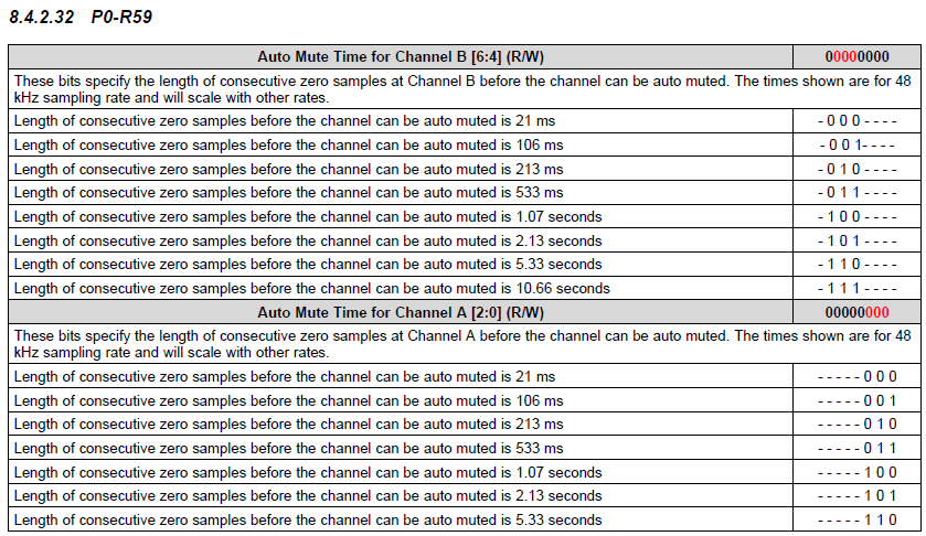

The auto mute time is specified the length of consecutive zero samples in the data sheet as below.
So, is the auto unmute time also same with this ?

  • Hi Kato,
    The TAS5754M/56M should be auto unmuted as long as the continuous zero samples are no longer present. The auto mute time settings are for auto mute control only.

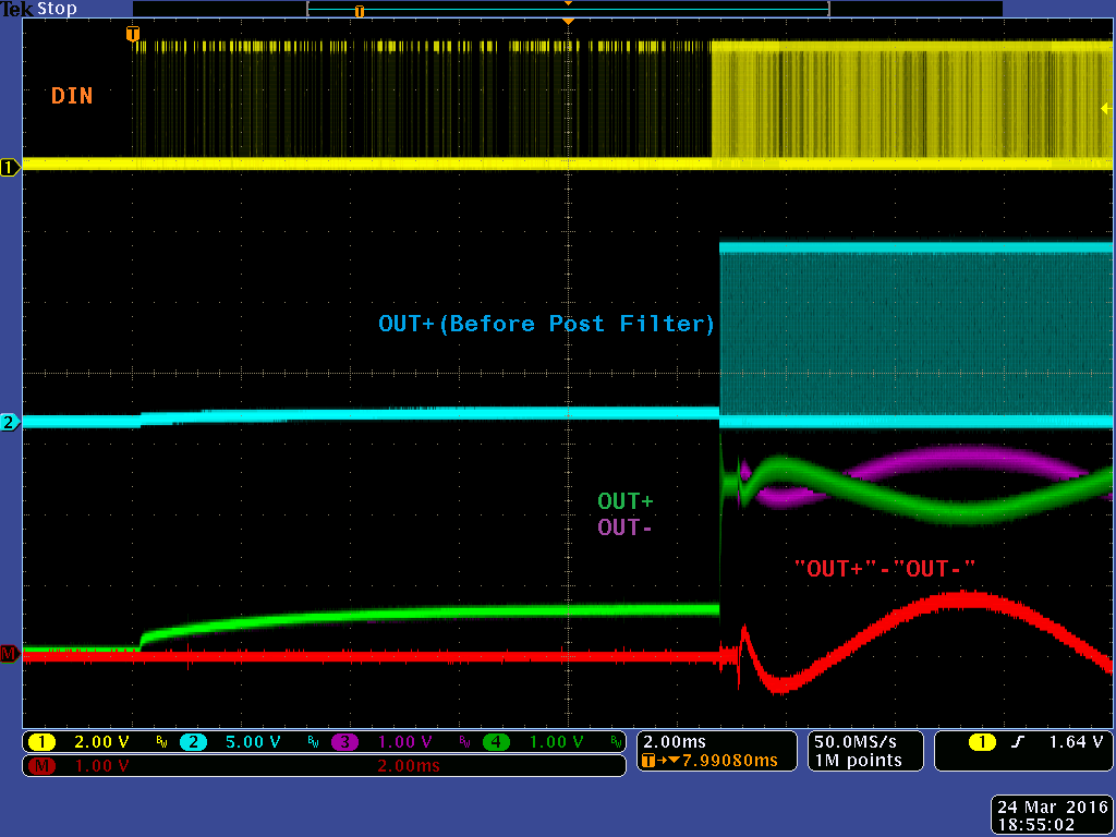

  • Hi Kato,
    I find there is a small (about 10.8ms) between DIN being non zero and PWM being on. Is that the same thing you were talking about?
    I guess it is the time delay for the device to complete the transition from the muted state to the unmuted state.  I will try to confirm that.
    Andy
  • Hi Andy-san,
    Thank you for evaluating the evm.
    Your understanding is correct.
    I have got the similar measurement result when unmuting by using P0-R3 register on TAS5754M evm.
    As you said, I also guess that this operating is depended on the hardware topology of TAS5754M/56M.
    So, do you have any methods to avoid this issue except disabling the auto mute mode ?

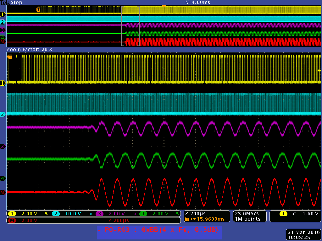

  • Hi Andy-san,
    Thank you for your quick response.
    I have also evaluated the analog mute function when unmuting by using P1-R6 register on TAS5754M evm.
    So, could you please give me your advice since the same result have not been reproduced as below ?
    <Condition>
    - Fybridflow4
    - Fs : 48kHz
    - Input Audio Source : 100Hz Sine Wave
    - PVDD = 12.5V
    - P0-R63 : 0xBB(4 x Fs, 0.5dB)
    - 6Ω Speaker
    - P1-R6 : Analog Mute "ON" or "OFF"
    - Default Settings except P0-R63 and P1-R6
    Kato

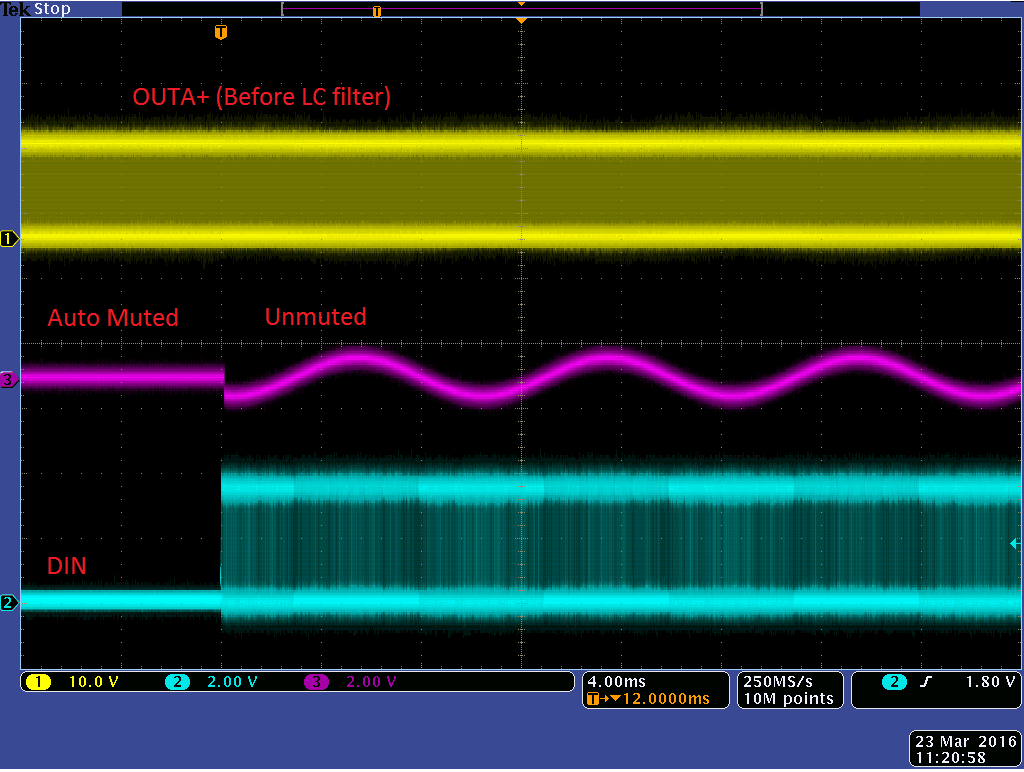

  • Hi Kato,
    Have you tried the HF5 with a 192kHz input?   Below is the xml file that I have used for that scope shot above.
    TAS5756M_HF5_PSIA_192K.xml
    Just in case your AP cannot support 192kHz, try this HF3 file below. I can see the same result as I showed to you.
    TAS5756M_HF3_PSIA_48K.xml
    Andy

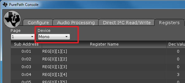

  • Hi Kato,
    I checked the HF4 as you requested. I got the same result as the HF3 and HF5 (See the scope shot below).
    Below is the xml file that I used for the test.  One thing I would like to point out is you must make sure you select the Mono device in the Registers tab when you disable the analog mute function. Actually I made that mistake at the beginning and forgot to switch the device.
    TAS5756_HF_HF4_PSIA_Auto_Mute_48K.xml

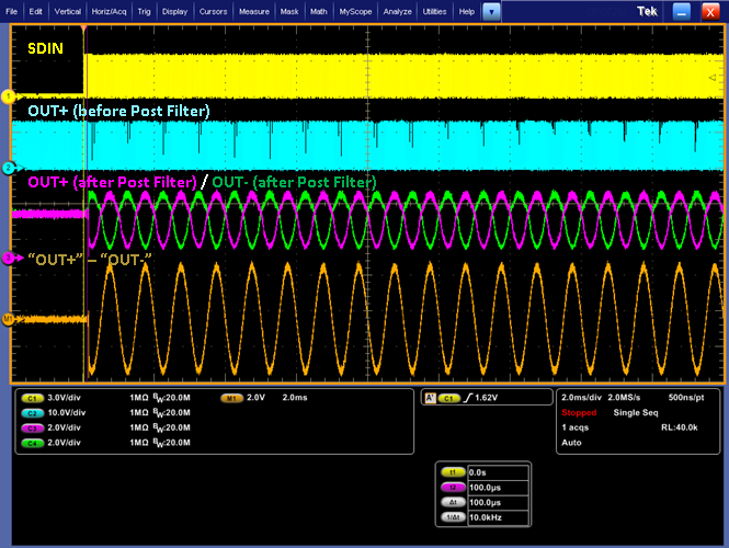

  • Hi Andy-san
    I have evalutated TAS5754M EVM and got some scope shots as below.
    e.g.)
    Target Volume              = 0dB
    Mute Volume                = -103dB
    Volume Ramp-up Step        = 0.5dB
    Frequency of Volume Update = 4/Fs[s]
    Fs                         = 48kHz
    Transition Time[s] = (Target Volume - Mute Volume) / Volume Ramp-up Step * Frequency of Volume Update
    Therefore,
    Transition Time = 17.17ms
    However, as a result of the evaluation it seems that this transition time is very short.
    Could you please give me your advice about it since I would like to estimate the transition time if returning from the mute mode ?
    Please point out if I have any misunderstanding.
    I will also evaluate it by using AP on your local office tomorrow.
    <Condition>
    - Fybridflow4
    - Fs : 48kHz
    - Audio I/O : USB
    - Input Audio Source : 10kHz Sine Wave
    - PVDD = 12.5V
    - P0-R63 : 0xBB(4 x Fs, 0.5dB) or 0x00(1 x Fs, 4dB)
    - 6Ω Speaker
    - P1-R6 : 0x01(Disable Analog Mute)
    Note : Default Settings except P0-R63 and P1-R6
    Kato

  • Hi Kato,
    See my comments below:
    Q3: Auto Mute and Analog Mute
    Andy : I confirm that auto mute is actually auto analog mute. If the analog mute is explicitly disabled,  you will not see any effect of auto mute.
    As a result of having compared 192kHz@Fs with 44.1kHz@Fs, is my understanding correct that the transition time depends on Fs regarding Q1 and Q2 ?
    Andy: The transition time you measured for the auto mute when analog mute is disabled should be signal path delay, which is related to FS of the input signal.
