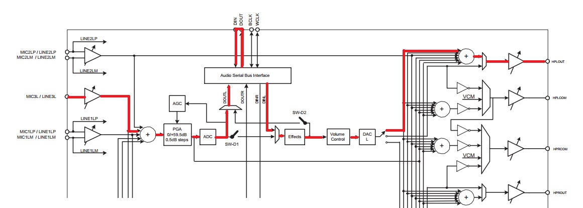

I am working on one audio application. In that I am trying to route Line_3L and Line_3R through DACL1/DACR1 path to the output.
I am using following amixer command sequence  to configure codec, but audio signal is not coming at output of codec. I tried in many ways but no success yet.
Its working fine when bypassing the input signal from PGA. May be I am missing some commands in between or command sequence is not proper.
Can somebody help me to resolve this?

  • Hi, Rajesh,
    If my understanding is correct, the following picture describes the signal path that you're trying to use.
    For this case, it is necessary to configure the codec as master (BCLK and WCLK as outputs). Also, the DIN and DOUT pins must be connected externally.
    Please let me know if you have more questions or comments.
