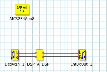

I have measured the delay between LINEIN and HPOUT as the PPS shows below. The delay between the input and out is about 0.96ms(fs=44100Hz), i.e. about 42/fs. The delay is obviously too large for my realtime active noise control(ANC) system. I guess maybe it results from the oversampling filter delay. I have read the Uses' Guide, and for decimation filter A, the ADC and DAC delay are 17/fs and 21/fs respectively, which may results in large delay between input and output. How can I disable the oversampling filter or how to decrease the delay between the input and output?

    The oversampling filter cannot be disabled on the AIC3254. However, the delay can be decreased changing the decimation and interpolation filter.
    • The decimation filter B is designed for sampling rates up to 96KHz and the filter delay is 11/fs.
    • The decimation filter C is designed for sampling rates of 192KHz and the filter delay is 11/fs.
    • The interpolation filter B is designed for a sampling rate of above 96KHz. The filter delay is 18/fs.
    • The interpolation filter C is designed for a sampling rate of 192KHz and the filter delay is 13/fs.
    I hope this helps you. Please let me know if you have more questions or comments.
