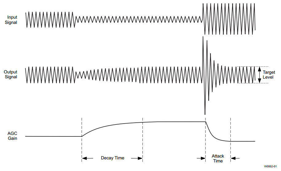

    We used TLV320AIC3101 in Ambrella/A12 to read and write Register 32 & 33 (AGC gain value), can't write, read out is a constant value 0x60.
    The data sheet shows Register 32 & 33 only can read ( refer as below picture),
    Our products in the S2l platform can be successfully read and write Register  32 & 33 (gain value AGC), the use of codec is TLV320AIC3101.
    please help, thanks!
  • Hi, Ray,
    The applied gain is determined by the AGC, that's why these registers are read-only. You must to program registers 26 and 29 in order to determine the AGC target level. Once this value is configured, you may program a maximum gain that the AGC can reach with registers 27 and 30. The AGC will try to reach the target level based on the programmed maximum gain.
