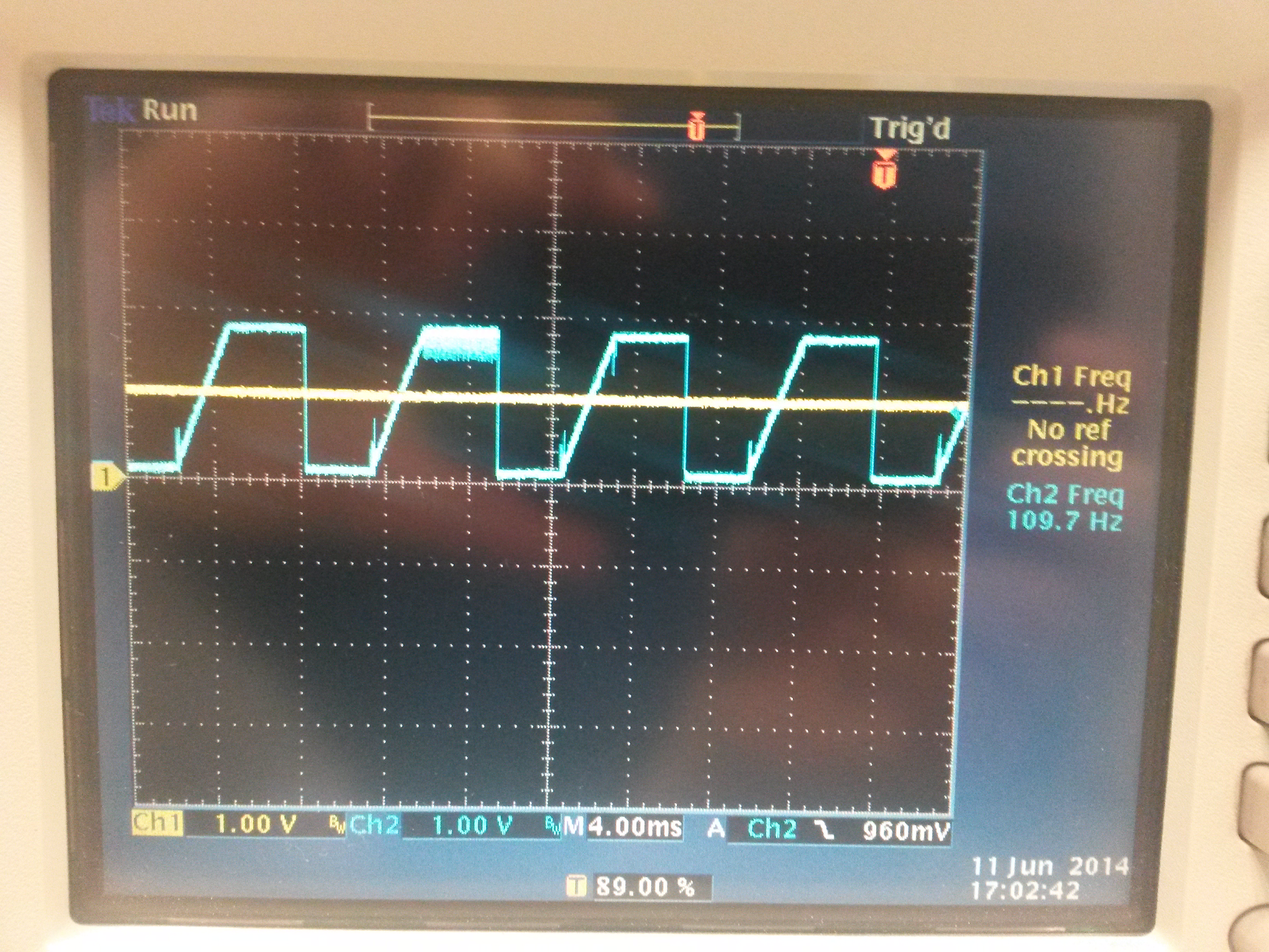

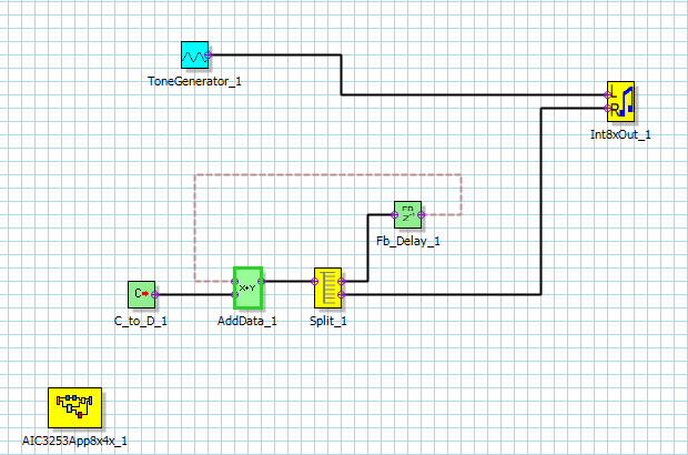

I am experimenting with the math. I have the following flow running on the TLV320AIC3253EVM-K. The left channel outputs a sinewave, which proves that I have my system setup correctly. I would expect that the right channel would show a saw tooth. Or maybe an inverted saw tooth?
I am getting this waveform:
Would anyone be able to help with debugging this? What are the data types?
Thank you.
