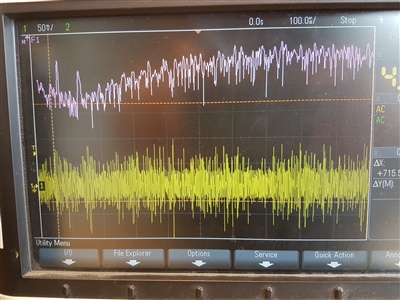

I am programming the AIC3120EVM using purepath studio. I am trying to take line input signal from music player (mic in), process it then output line-out (HP out)
I managed to get this working using Purepath studio and clicking the "ADC to DAC loopback" button in the codec control.
However, the output is really noisy. There is like over 100mV of noise on the output. Perhaps it is to do with the class-d amplifier which I am not using. I'm plugging the output into a 26db gain class d amplifier and speaker. The noise isn't coming from this incase you wondered.
Why is the output so noisy?
1) I'm not sure how to output my configuration file. I haven't really touched anything, just run the AIC31XX framework and added dec and int inputs and outputs and a few biquads to test. Then clicked the loopback button in the codec control
2) How do I turn off the HP amplifier and place it in low power line out mode?
3) How do I turn off the class-amplifier?
I want to test the noise level before I use this part in our design. It shouldn't be this noisy.
