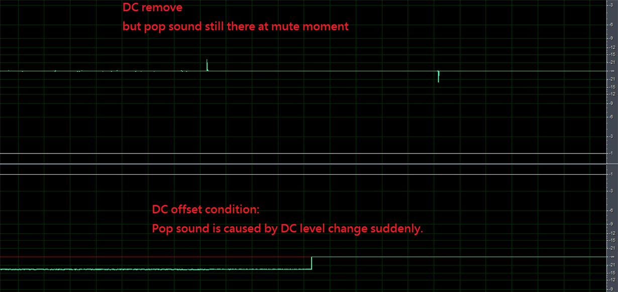

Hi All,
I am using AIC3204 and meet ADC mute pop sound.
For some reasons, AIC3204 ADC is the final node in my audio path, I cannot control any signal mute function after AIC3204.
At the first, I noticed the DC offset exists, and transfer to data 0 suddenly while muting; pop sound occurs. (fast DC level changes!)
After trying a whole day to enable ADC buffer A to remove DC, but the pop sound still here...
The attachment MP3 is what I did about the issue, you can find L channel is DC free, but pop sound happen while mute (5s), and unmute(9.5s); R channel is DC biased, pop sound occurs while mute (7.5s)...
Does anyone can help my problem??
