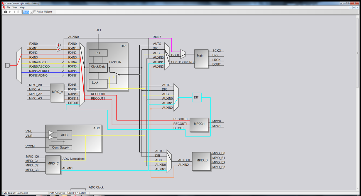

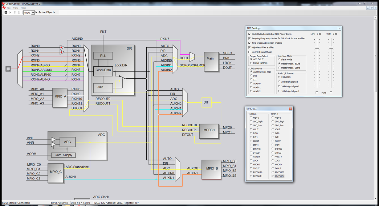

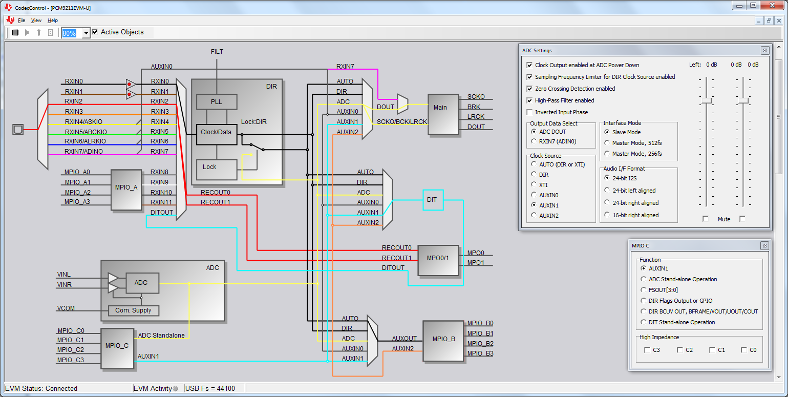

  • Hi Justin,
    I have been looking again at it today. With the standard startup script I still have no audio from the USB device, just full scale noise.  Settings shown below:
    I have found that if I use the following settings I can get good audio from the optical output, but still just full scale noise on the USB audio:
    If I switch the RECOUT0 and RECOUT1 source to be DITOUT on the input MUX I do not get any audio, and also if I click on MPO0/1 and set them to TXOUT there is nothing.
    I have also tried using the ADC input as shown below:
    In this case my audio analyser cannot lock to the optical output if MPO0/1 are set to RECOUT0/1. If I set them to TXOUT the analyser can lock but has no audio.
    The soundcard output is variable, sometimes it is full scale noise, sometimes it is -100dBFs, but at no point is it correct audio.

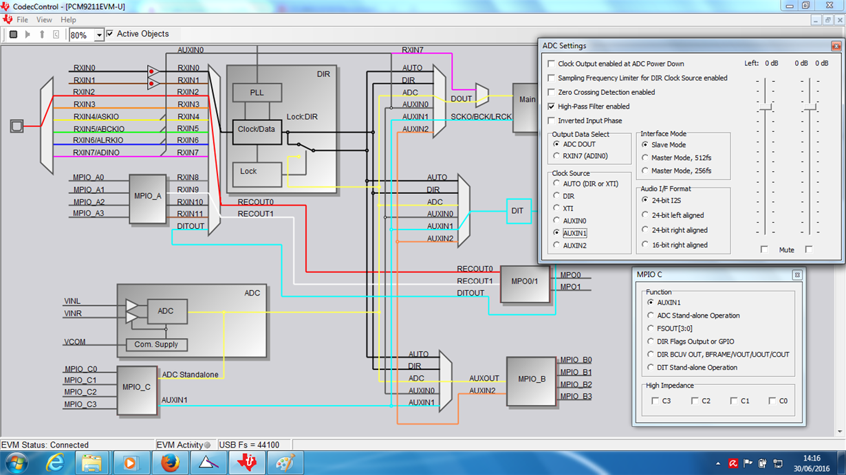

    Thanks for your reply. I have had a quick look at it again this afternoon based on your recommendations.

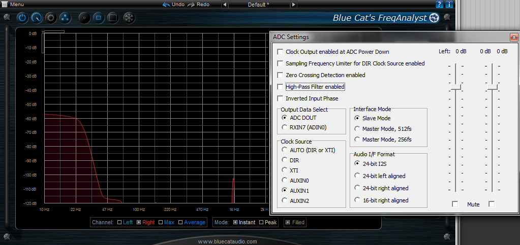

    Removing W9 and then resetting did not immediately produce good audio, but I have found that if I change the ADC clock source setting away from and then back to AUX 1 gives some audio. I suppose that the it needs resending after the reset, it is strange that this is not needed for any other setting.

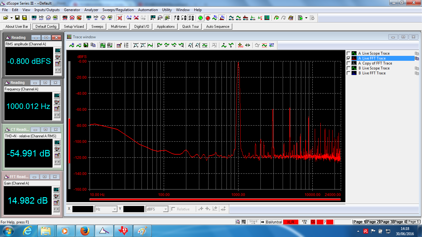

    Although this produces some audio it has a very high THD, around -54dB, so clearly something is still not right. Photos attached for reference
    Justin do you have any further suggestions? It has been almost a month now and I still do not have the board working as it should.

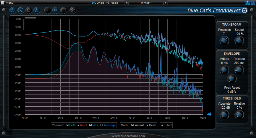

  • Yup. After removal of W9 and a reset I was still getting masses of signal burying noise on L & R channels with the SBAA179 instructs. But - as Mr Whyte suggests - switching away from and then back to AUXIN1 appears to clear it. If you hit reset again, the noise comes back, but flipping from AUXIN1 to (say) AUXIN0 and then back to AUXIN1 again clears the noise. It's completely repeatable.
    I also see a difference on a 1k 0.5V Sine signal, with the enabled and disabled Hi-Pass filter ADC Settings checkbox (again, a la Mr W's image above) - no filter:
    Then with filter:
    But the low frequencies may of course be coming from elsewhere - I'd not blame the card.
    Finally, here's a Harrison Birtwhistle String Quartet, with peak L & R spectros.
    So, still a bit of principle-of-least-astonishment-violation weirdness with the state machine, but it seems it _is_ possible to get something in through the stereo jack.

    I must say that looking at your FFT the peak at 1kHz seems very low for a 0.5V input signal. Less than -100dBFs, in the same order as the DC offset/very low frequencies, it does not look correct. On the other hand you clearly have some audio in your last screenshot. Do you have a figure for THD+N?
    I will have to look in to why my board has such poor distortion performance.

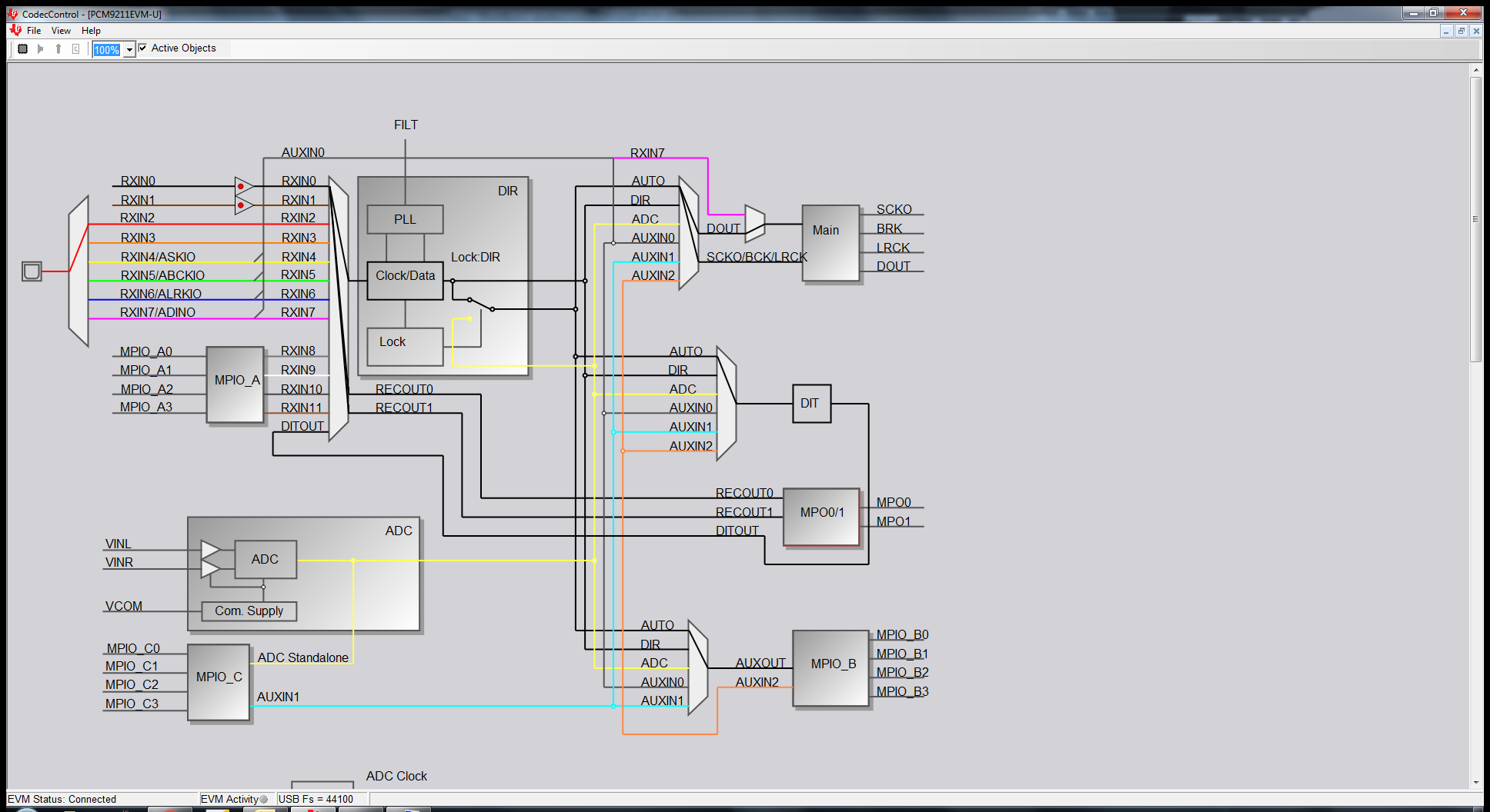

  • Well, these are the steps I made to get the EVM working:
    - Remove jumper W9
    - Connect the EVM to USB
    - Connect an audio source to the analog input of the EVM
    - Start CodecControl (during start-up, CodecControl will detect and initialize the EVM)
    - In the GUI, connect DOUT to the main output block to ADC source
    - connect the SCKO/BCK/LRCK also to ADC source
    - In the MPIO C configuration, set the function to AUXIN1 (default)
    - In the ADC Settings, set Clock Source to AUXIN1
    With these settings, I get flawless audio channeling through the EVM.
